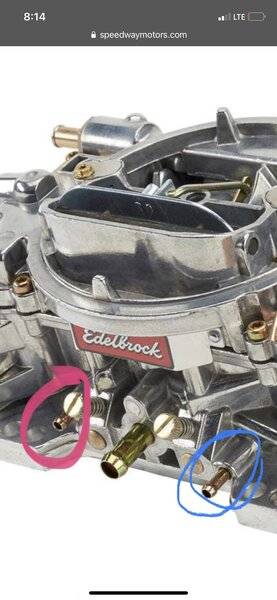

Greetings- I have a mild 440 in a 66 charger. It has a edelbrock 1407 750 CFM carb. When the vacuum advance is attached, the motor stumbles and misses at idle. When I disconnect the VA, it runs MUCH smoother. So I bought a vacuum gauge. I get 25” from the pink pink port and 30” from the blue port… at idle. It’s advancing way too much at idle. Distributor is set at 10° initial. Engine is also running richer than bill gates. Yes I’ve used the vacuum gauge to zero in my idle mixture screws. What gives?

You sure your throttle plate is closing at idle, as that "pink" port on the Edelbrock is ported vacuum..
No sir I am not. Edelbrock website stated the “blue” port is manifold vacuum but I get over 30” at idle. Was going to ask if something is wrong with the carb

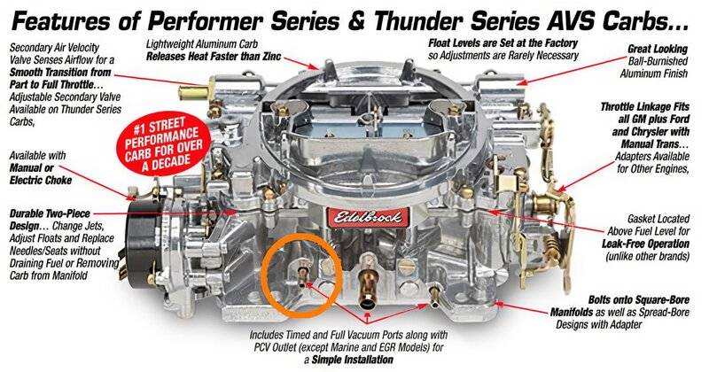

Dad is correct. The ported (or "timed" as Edelbrock likes to call it) is on the left and up off the throttle plate
some; the middle big port is for a PCV and the smaller, lower one on the right is for full time vacuum:
The orange circle indicates the ported ("timed") vacuum outlet; it will have ZERO vacuum at idle if the
carb is adjusted correctly. The other two ports have all the vacuum the engine generates, all the time.
