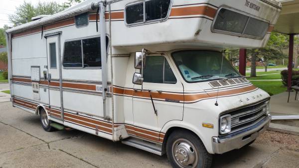

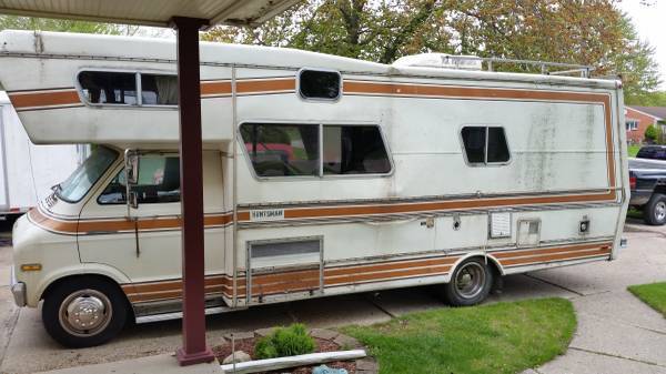

    Does anyone know what stock cam specs would be for a 1977 440, RV motor? Tried to find the camfather site, couldn't find it. Just need to know what lift and duration are for the cam I have in my 440 RV motor, that is now in my car.

    I don't have a '77 Factory Service Manual, but in my 1973 Truck FSM the cam specs were the same as what was used in the cars.

    According to the old MP engine book, there were basically two cams used.
    The HP cam, and the non-HP cam.
    You’d have to assume a motor home would get the non-HP cam, which would have the same specs as a Sealed Power CS-327.
