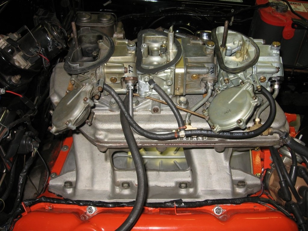

I believe this is the intake mentioned above. Yes there are lots of modifications published in the Mopar Encyclopedia Engine Book. All were performed on this one, and it won't run nearly as fast as my stock 6bbl intake. I messed with this thing for years, and multiple motors. Finally I gave up on it. My buddy had to have it. He mounted it on his car and it slowed down by .4! I like to tinker, but that thing owned me!!
