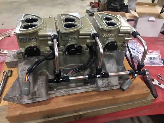

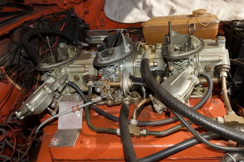

I had to take the carbs off to replace the accelerator pump. The cracker rigged fuel lines had to be cut - just the center one, to get to the cracker rigged Allen head bolt.
Has anyone dealt with fuel lines for something like this? I'm working on using stock lines but it is a :BangHead::cursin::BangHead::cursin::eek::eek::eek::realcrazy::realcrazy::screwy:.
Just thought I'd check and see if anyone here has any experience with this fargin thing.
You can buy the factory fuel lines and tweak them to fit. They will have to be curved a little upwards to clear the manifold. STR manifold ? You can always keep the brass tees and flare your own lines.
I've spent hours tweaking...never done this before so it's :BangHead::BangHead::BangHead:. I looked in to flaring kits - over $200. I'll do AN lines if this doesn't work. It says CHRYS and Edelbrock and it's aluminum.
yes its the Edlebrock STR-14 for RB STR-15 for B motors "street tunnel ram" You can buy a cheap flaring tool for $35 but it will not be good for stainless lines. soft metal or copper only with the cheap tools.

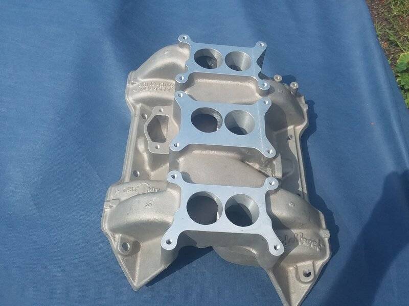

Educate me, what's special about that intake? It was on the car when I bought it.
You have an STR 14 or 15 (one is a b, one is an rb) stands for "street tunnel ram" They were available with three different tops, single four barrel, six pack, and dual four crossram. They have been out of production for decades. Twenty years ago, you might have trouble giving one away, now they are an absolute premium nostalgia manifold, and certainly not cheap!

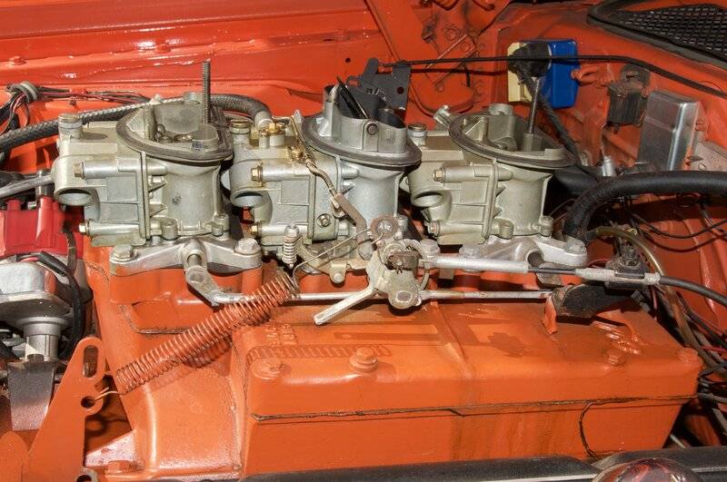

There were some internal fixes for distribution troubles (glued in popsicle sticks and such), but you would have to find an old mopar engine manual to find them. They are NOT necessary for street use. I'll post a pic of the normal 440 six pack manifold to compare to yours.

Don't mean to sound like a jerk but I have a stock original six pack 440 on another car - I'm looking at how the stock lines fit on that to compare...they hang down like you say. So am trying to get the stock ones to fit. Whoever built this car didn't even bother with stock and used the wrong bolts under the fuel lines because that is one tight damn squeeze.
