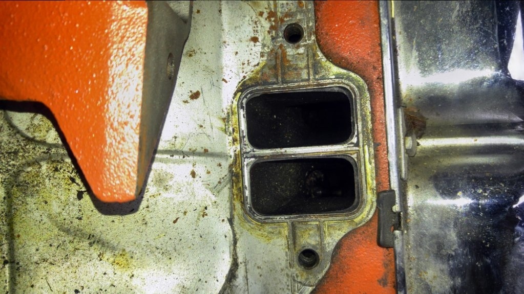

    You're prob looking at 12 to $1500 for the six pack set up. I just bought a brand new in the box set up for $2500. Complete with all linkage and air cleaner. Remove the intake from the motor and look at the cyl head intake ports closely. If they are max wedge heads, the ports will be much larger on the heads, and the intake manifold ports wont match up. Something not quite right here. Double check the head casting numbers.

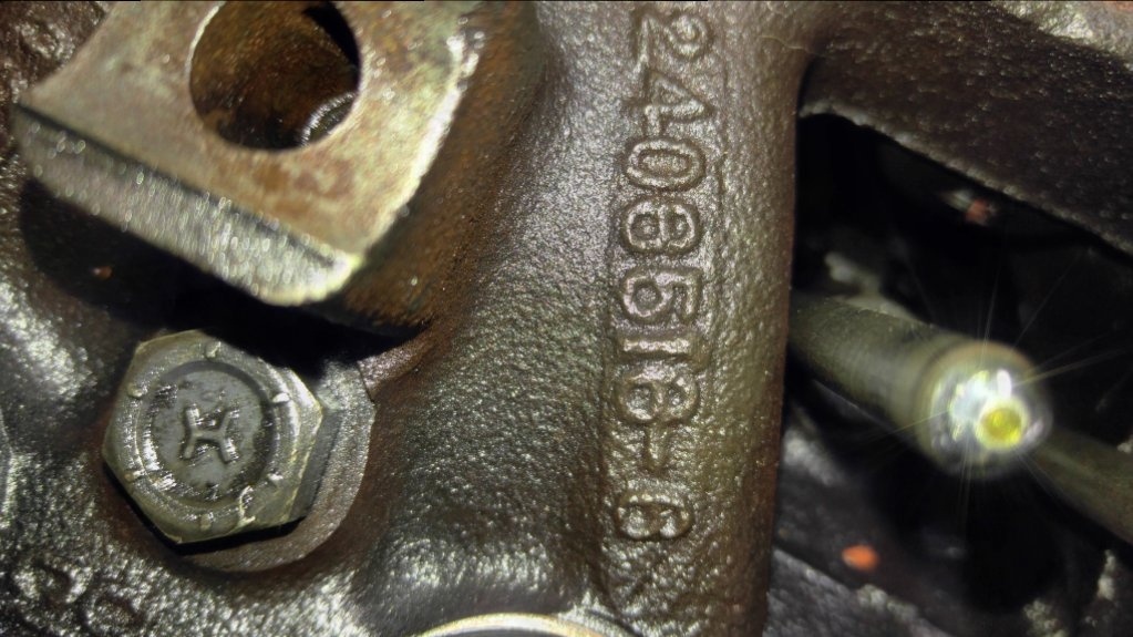

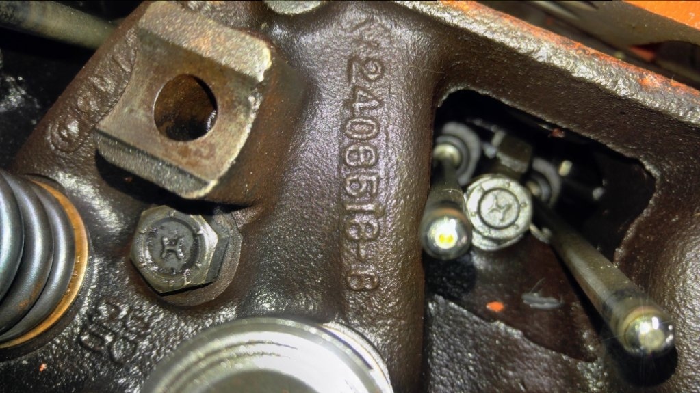

    20160509_182853.jpg 20160509_182908.jpg 20160509_182938.jpg Took the rockers off to get a clearer look at the casting number. One shot it sort of looks like an 8 and then the other looks like it could be a 6. Here is a couple pictures of it. Last picture is a shot of the intake port.

    Upon further investigation and thanks to an article done by Hot Rod, it appears as though amidst a lack of knowledge and being admittedly green to the hobby, I've mistaken the heads to be Max Wedges. Still not quite sure what they are, but I now know the Max Wedges lack a heat crossover passage which these heads have. Are the 516 heads good heads? I mostly only read about the 906 and 452 heads on here.

    The 516 heads are a closed chamber design, which I like. They also have 1.60 exhaust valves, that I don't like. Another drawback to these heads is that the intake port flows less air in stock form, compared to the 915 and 906 heads. They came on the 1965 and 66 383 engines, as well as others. In 67 the 915 head was introduced, where the intake port was re contoured and flow was improved, and the ex valves were enlarged to 1.74" diam. Some of the 67 915 heads had 1.60 ex valves. You can make good power with the 516 head, with the right modifications. There are some threads here, where that head was used in ported form on a 440, and it ran quite well.

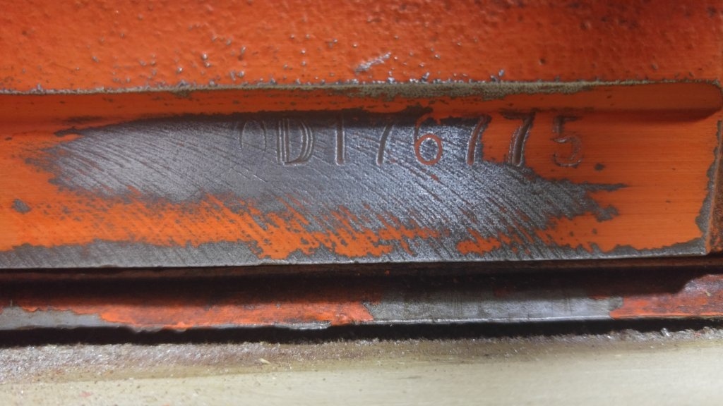

      Partial Vin above the oil pan on the passenger side is the way to tell right? There would be a V or M indicating 6 pack for 1970 I think? Here's a picture of the partial Vin. If I understand things right the D would be the plant that it was assembled at? And the intake is cast iron. casting number is 2946276 and there is also a date tag on it that reads 10-22-69
