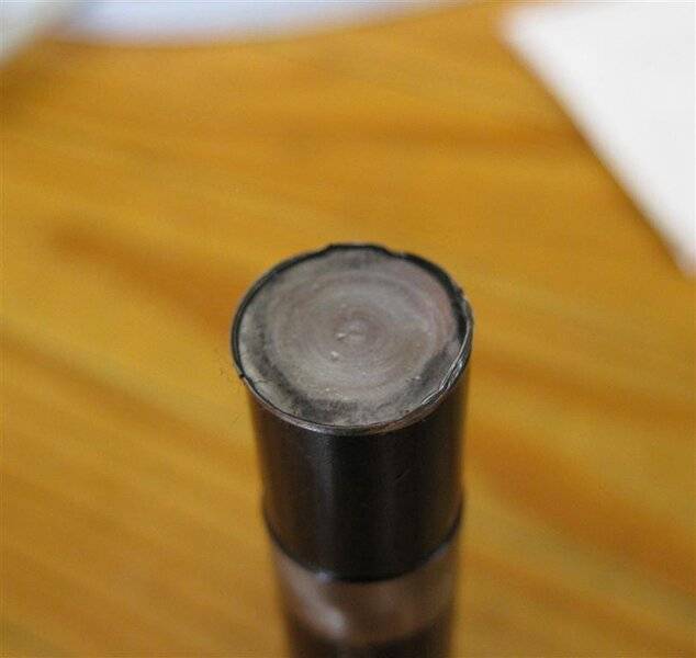

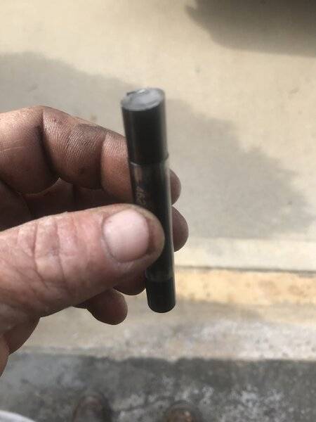

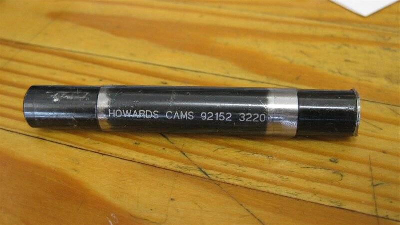

Can someone tell me why/how I have only 4 psi fuel pressure new stainless 3/8 fuel line front back new Carter fuel pump that's rated to 9 psi.new fuel pump rod it's a Howard's hydraulic roller cam does that have anything to do with fuel pressure I love my car and I am very patient man but damn it's aggravating .When it runs right which isn't very often it's a beast
Plugged pickup/tank sock, plugged fuel filter, ...new rod can go bad right off the bat (common problem). Where are you measuring the 4psi?
Measuring at carb line tank sock and pickup tube all are new the rod is comp cams new
Did you make sure to get a pump rod made for a roller cam and not the oem replacement for an iron stick?
Like said above. Also get rid of that Howard's pump rod.

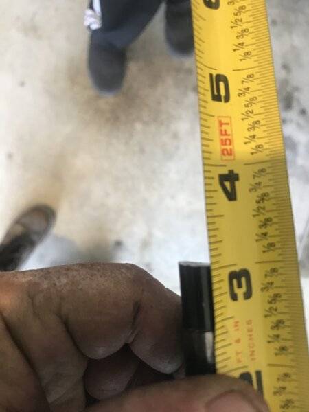

Rod is 3.22 when I cold started yesterday it was at 10psi but after running few mins dropped to 7 then after few moe mins dropped to under 5

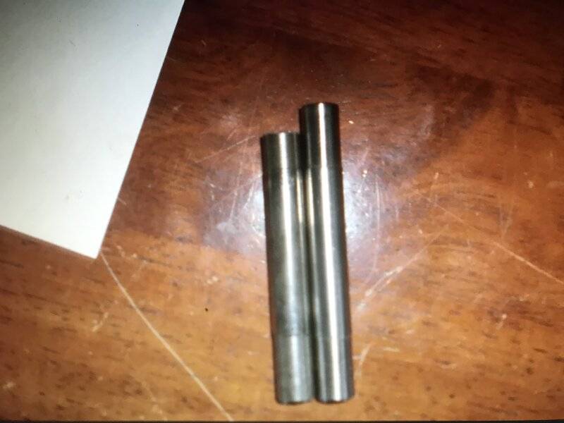

Interesting, I'm building a Howards roller cam mill and I used a comp cam pushrod... the one with the bronze end..towards the cam..
Still in assembly mode though

If the roller cam is billet (yes, there are iron rollers), it WILL need a bronze tipped rod with the bronze tip to the cam. I would say your rod got waisted as it wore down, thus resulting in lower and lower pressure due to a loss in stroke for the pump. Hopefully, the cam didn't get damaged, or go to electric as stated above.
The billet cam + fuel pump pushrod pairing rarely works out well in the long run.
Electric is the way to go with that combo.
