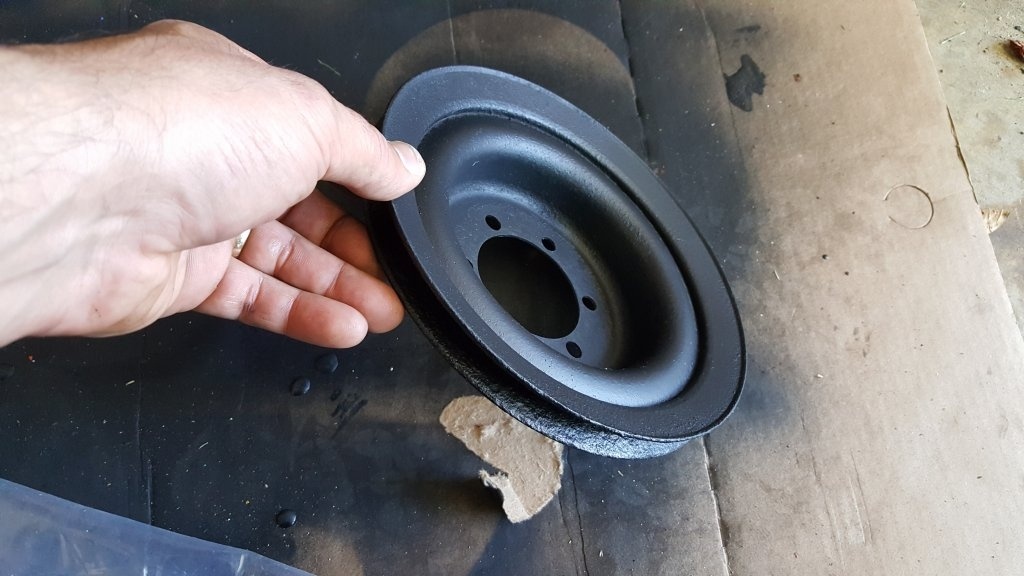

So during my 383 build, I decided it would be a good idea to add a new damper to the list. I ended up going with the black sfi one from 440 source. So today I dropped the engine/ Trans in the car. Went to put the front accessory drive together and found the factory main pulley will not fit into the 440 source damper. The bolts in the damper are recessed and the inside diameter is smaller than the pulley. Has anyone else ran across this ??

Well with a damper inside diameter of 4.43", and the pulley diameter of 4.57", it's a no fit !
i just measured a 440 source re-pop single groove pulley. i'm getting 4.32.
So with that, it looks like it will work with their pulley. Wish they would advertise that when reading the description of the damper .... thanks for that info .... while you're at it, can I get a total outside diameter of that pulley so I can compare it to the factory one I have ? Thanks
6.54" o.d., single groove. there's probably a multitude of different factory pulleys.
Ok, so without the bigger single groove pulley everything fits and lines up .... I can't remeber what that single one was for ?

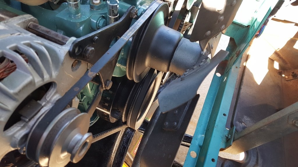

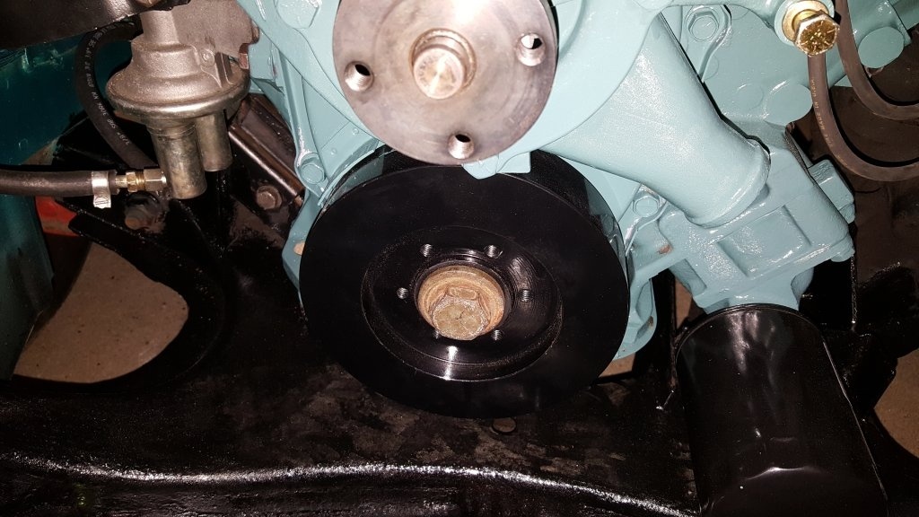

Thank you for the offer, I actually got everything on and lined up. I used the original 2 groove crank pulley. The problem was the larger single groove that went between the 2 groove and damper, that one would not fit. I decided to leave it out and see how things lines up, looks good to me ! I still want to know what that large shallow single groove was for though ....
