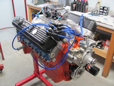

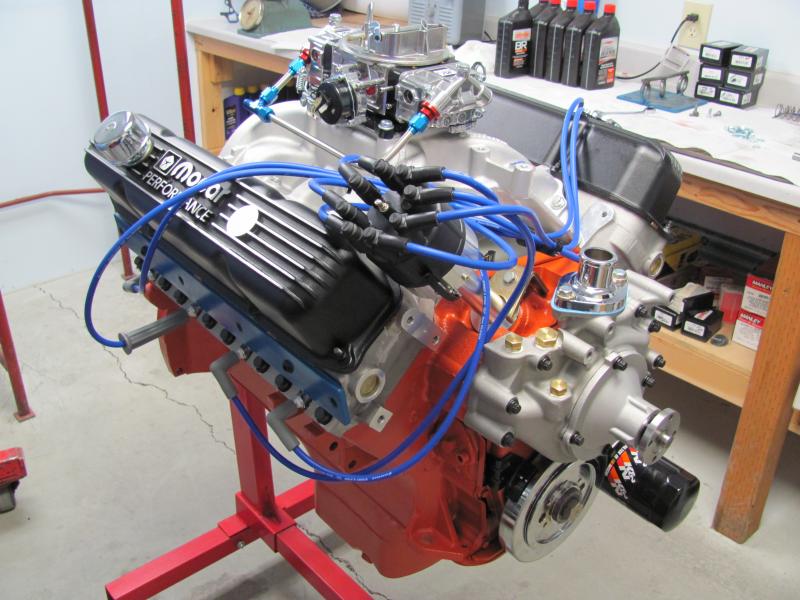

440, 10.5:1 compression, 91 octane, service prepped Stealth heads (250 cfm @ .400, 278cfm @ .500), RPM intake, ProForm 750cfm 4150, XE284H cam, 551 LB-FT @3,800 rpm and 514 HP @ 5,100 rpm.
