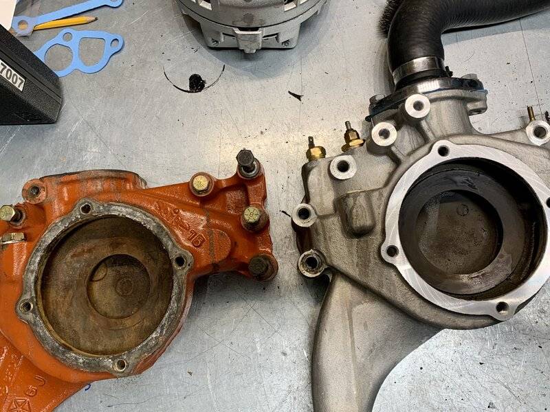

There was a thread or two about the same question not long ago. Someone questioned the 440 source housing and posted a pic of an original 440 pump from a motor home verses an aluminum housing from 440 source. I just bought the one from them as I have an original 68 motor.
Here is the picture that was posted:

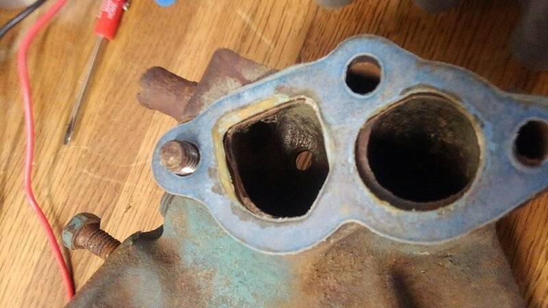

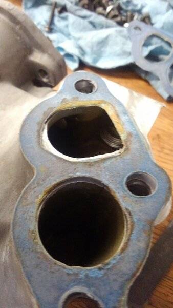

My 440 Source housing doesn't have restricted port sizes but they don't match up well with gasket holes. Stock versus 440 Source comparison, gasket shows stain from overhanging and running with 440 Source housing.
