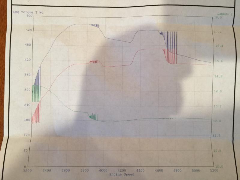

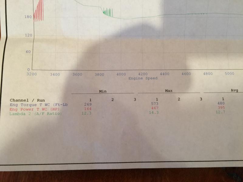

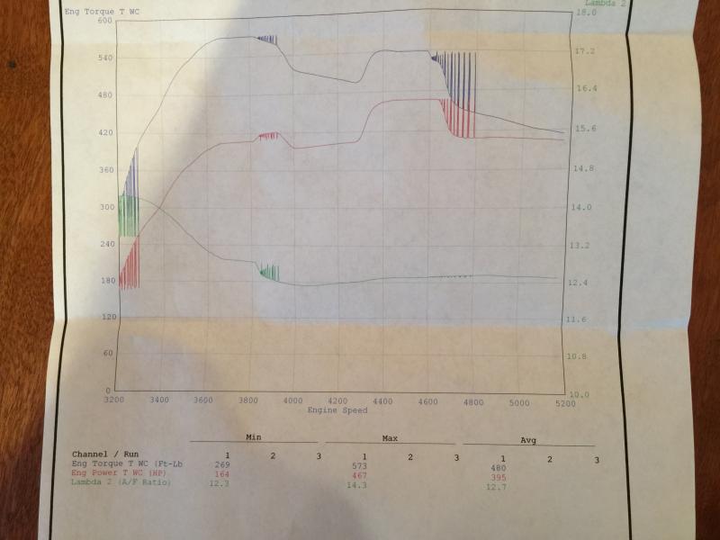

I had my 1969 Coronet R/T 440 engine bored .040 and stroked to a 499 cid using an Eagle rotating assembly, .040 Wiseco pistons, roller camshaft (do not know brand, maybe Comp Cams) Harland Sharp roller hydraulic lifters, high volume Melling oil pump, Moroso Perm-Align valve cover gaskets, 3000 stall converter with ported Indy EZ-1 heads and port matched Indy intake. The cam is 545 lift with a 235/241 duration and 110 lobe separator / 106 centerline. The compression is 9.6 to 1 and this seems too low for a stoker. The engine builder put it on his chassis dyno and it had a peak horsepower of 585 (I have to look at the dyno sheet at home for the RPM and torque numbers). I am a little disappointed as he claimed it will easily get 650 HP with 450-500 at the wheel. I had a little 340 stroked to 416 that produced over 500 HP in a 1971 Demon that I sold a few years back. Does this sound too low of a HP gain? I think a 500 cid engine with these ported heads should easily hit over 600 HP.
