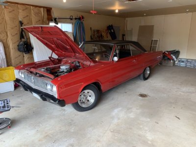

Hey guys just want to pick your brains. 67 coronet with power steering. I am swapping a rebuilt 77’ 440 in and I am looking to buy headers what fits best? Long tube, short tube? Suggestions? Also will I need a mini starter? Thanks
Always depends on you budget. TTI is first in my book then Dougs. A mini starter is suggested in most cases. Also weight savings.
I've only installed one set of short tube TTI's and dozens of their long tube sets. The short tube are so easy. Most of the time I install the complete headers and full exhaust.
depends on your cam, gears etc
for most long tubes work best performance wise not huge dia or short collector
ask around
do the mini starter and not look back
did you say stick or auto?
ask around
