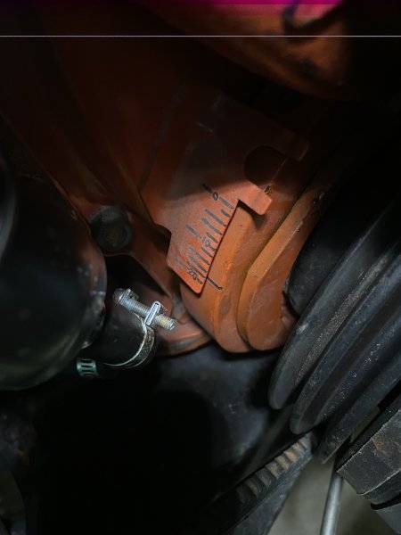

So is this advanced 20 degrees? So should I be close to where the rotor points to the #1 plug wire? Thanks in advance.
Yes... you'll need to confirm with a light once running.... BTW, 20 initial advance is kinda a lot on most engines at start, which is what you are doing right now.... I'd dial it back to 5 to start most likely.
Depends on how much cylinder pressure the engine has. If it's 8.5-1, cylinder pressure (with a stock cam) will most likely be low and will like more initial and total. At least that's the way every low compression engine I've worked with was. My recommendation is to give it what it likes.....
You need to know how much mechanical advance your particular distributor is providing at around 2500-3k, then set your initial accordingly for about 34-36 total. If you have for example 20° mechanical, you can go 14-16° initial and make adjustments from there. Some distributors have as much as 30° mechanical (mine did) Combine that with your 20 initial and its much more than needed.
your rotor should be pointing past #2 plug wire and a little bit before #1 plug wire in your dist cap.
