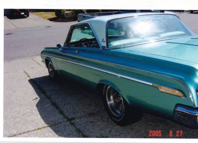

Has anyone converted a 1964 440 to a real Polara? I'm talking the hood chrome, trunk two-chrome strips, taillight full width bezel, center backup lights add. And Polara side chrome for good measure?

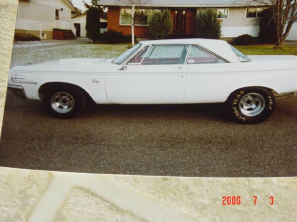

440's are OK, but I'm crazy about the taillights on the Polara and the chrome strips on hood and trunk. I've owned two '64 Polara's in my life (both white hardtops, one four door and one two door) and kick myself for selling them every time I see one. :BangHead:

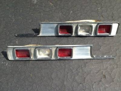

Not those. I am talking about Polara Tail light housings and a Nos pair of them... Like these pictured below from a member of this site..

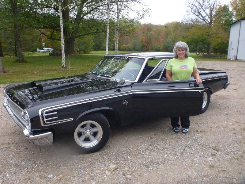

When I did my Polara I did have all the trim but I spent quite a bit of money rechroming the taillight surrounds and quite a bit of time fabbing up trim cliips for the side chrome. I salvaged the clips I could but others I had to make. You just don't go to Pepboys and buy them all.

It is hard to find Polara tail light base plates that do not have the fine grooves destroyed by pitting. These pieces are impossible to repair and rechrome. However, Bill at Special T's near Chicago has come up with a set of machined stainless steel panels that replicate this appearance. They sit on top of the damaged area, and are held in place by the tail light bezels. Although they are not inexpensive, they are way cheaper than repairing a bad set or buying NOS pieces. I bought a set and installed them on my '64 Polara. Although they would not likely fool a Concours judge, I am happy with the improvement in appearance for the $$$ spent. Repro tail light bezels have been produced, but most of them have been bought up. It might be time for another run of these. Be aware that there are 3 different bezels depending on application.

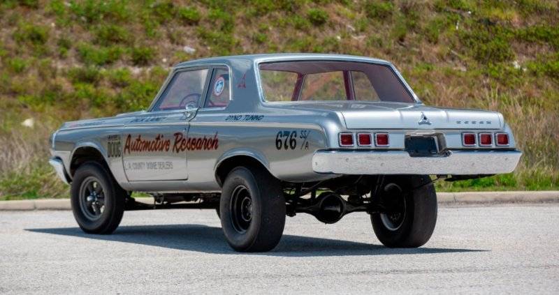

Dick Landy liked the three tail light look so much he would add the extra ones to his 330.

The bezels that mount directly to the car body ( 330 series and U.S. 440 series ) have a left or right curvature to match the fender shape. This is the outside left or right bezel. The inside bezel is a flat one like the ones used in the Polara base plate. Canadian 440 series use a shorter base plate than the Polara, and use the flat bezels. I found that I had to use two tail light lens gaskets under the lenses to hold them tight, after installing the new repro pieces on the original base plates.
