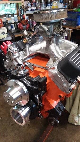

The pump on my 440 is a right hand exit MH pump....
