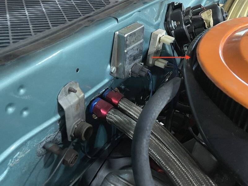

I finally put a PCV valve on my 440 6-pack and noticed something odd. I have the air cleaner where the orange top seals around the oval filter but leaves a gap so you can actually see the air cleaner. I noticed that the port from the passenger-side valve cover to the air cleaner that is pulling air for the venting of the engine is outside the air cleaner. I always thought it was supposed to be drawing air from the inside of the air cleaner. I know it's pulling a lot of air as I can see a faint smoky mist coming from the middle of the filter into the opening at the bottom of the air cleaner base.
The arrow in the pic is pointing to the opening on the outside of the filter that is leading to the intake port for the crankcase ventilation.
Is all this normal? It's been a long time since I've fussed with PCV stuff. Does it matter if the air being drawn in is just fresh air or should it be air from the inside of the filter?

I got all of this. The opening at the base of the air cleaner connects by hose to the port at the top of the valve cover on the passenger side. On the other side the port at the top of the valve cover connects to the manifold vacuum source at the base of the center carb. The vacuum draws from the driver side valve cover through the PCV valve which pulls air from the engine, Said air comes from the passenger side from the hole at the base of the air cleaner. Got it, all correct.
My question was whether it's 'normal' for the air to be drawn from the outside of the air cleaner as my setup has it or should that air source be inside the air cleaner.
It is normal on the non fresh air six pack cleaners.

It's normal even on a double snorkel cleaner, they all draw from outside the filter.... if they were hooked up inside between filter and carb throat you'd be in a low pressure area and both the breather and PCV would try to suck air out of the engine.

I think it is outside the air cleaner to guard against a carb backfire as the filter will diffuse the flame, the pcv has a check valve for the same purpose.
Your air inlet is the correct position - BUT.
The PCV inlet air is filtered - stock the air inlet breather cap is packed with a thick felt type material.
If your cap is open you will get a lot of crap drawn in to the engine and the oil will get dirty.

I agree with #11's assessment. The hose connects from the valve cover breather to the nipple on the air filter base with a short length of hose. At zero manifold vacuum, the crank case fumes will be directed to the air cleaner base and presumably (hopefully) will be injested thru the filter, preventing these evil gremlins from being discharged to the atmosphere.....

Actually Ford and Mopar also used air pumps on some years to help clean up emission's. But on the closed PCV system like the pic posted on #11 the reason they did that was so at wide open throttle when vacuum is about zero instead of crankcase fumes pushing out the valve cover with the open breather the fumes will go back into the air cleaner and still get pulled into the eng and burnt when vacuum is to low to pull the fumes through the PCV valve. Just part of the emission updates over the years and as was said most of the breathers all have a filter type system in them to filter the air the pcv system is pulling into the eng. And as said yours looks right. Ron
