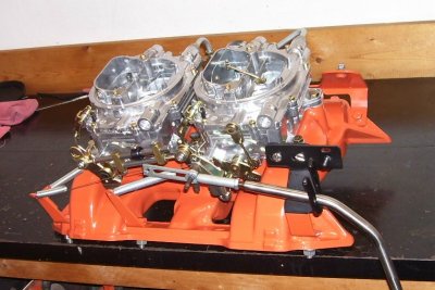

the 284-.484 cam isn't a bad choice for what your doing. you can get a little adventurous and try something that will give low, mid, and top end power.
