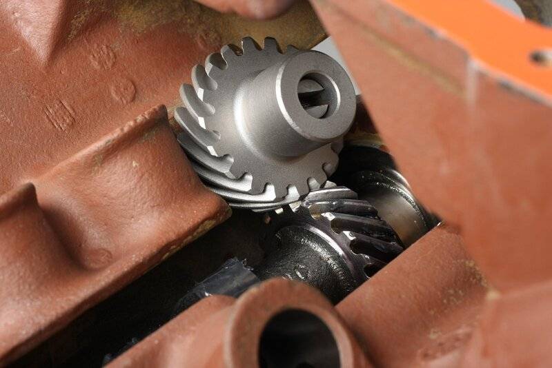

At the risk of being disliked, I will try and explain why a big block Mopar NEVER
needs a cam button. I don't know who started this useless idea, probably a Chevy
guy that decided to build a 440. If you look at the direction of rotation of the crank
shaft you will see that the crank drives the cam, which is pinned to the block by the
direction of the helical teeth cut in the cam. Besides this, the cam is also driving
the auxiliary shaft which drives the distributor and the oil pump. All of these things
are a load on the cam, sprockets, and chain. There is no physical way for the cam
to ever move forward when it is engaged with the auxiliary shaft. Just can't happen!
Save your hours of labor and don't waste your time with a cam button on a Big
Block Mopar. Thank You!

Won't hate. I'm just going by what the writers of "Big Block Mopar Performance" book wrote for installing a roller cam. A flat tappet cam lobes have a very slight angle so the lifters rotate and this angle also keeps the cam back, roller cam lobes are flat. I'm not an engineer n definitely didn't stay at a Holiday Inn Express last night, just following the suggestion of those who wrote the book.
Well, I'm a retired Machinist who has been tinkering with these things for a long time and
did some drag racing in my last life. All kinds of hair brain ideas have been put out there
over the years for racers and most are good, but some are bad, or in this case a non issue.
I've seen a popular guy on YouTube even have a video explaining how to put Cam Button
on a 440 and when I wrote him a personal message to call him out about it he explained
that it was just a general video that was pertaining to alot of different engines. I'm just
trying to help people on this forum that are mis-informed. I scour this forum because I
am still learning from everyone here while restoring my own car. Just hope this helps!

Have you personally used a roller cam in a B engine without a cam button?
No sir, I haven't, but if you look at the pictures that I provided you can see that if
the cam tries to move off of the thrust face of the block, it would have to shear the
teeth off of the auxiliary shaft. Looking at the front of the engine, the rotation is
clock-wise. The distributor and the oil pump are trying to slow down the cam and
because there is a helical gear on both cam and auxiliary shaft, the cam is always
thrusted to the back of the engine.
