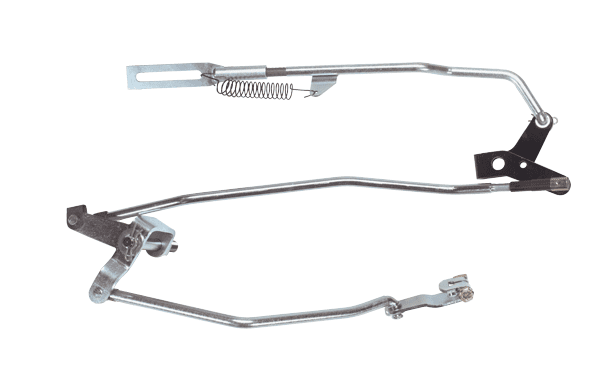

Well with a 361 I'm assuming a early 66 Charger? I assume your 2bbl kick down linkage is a 3 piece set up? Should have one rod from the carb to the pivot on the back of the intake, then another rod from that pivot down to the transmission bell housing area, then one more rod from that point to the kick down lever.
If it is a 3 piece set-up you should be able to get a kick down set-up from any 383/4bbl from 66-69
Should look something like this...
so the only piece that would most likely work in your current set up is the lower pivot and rod to the kick down lever...the other pieces will be shapped differently and be of different length to work with the 4bbl linkage and intake bracket.

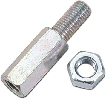

I'm not sure what the kickdown linkage looks like on a 361, but Edelbrock makes an extension (8004) for the top kickdown rod just for this purpose.
https://www.summitracing.com/parts/edl-8004
And that's assumuing you're using the (1481) Mopar adapter on the edelbrock carb.
https://www.summitracing.com/parts/edl-1481
