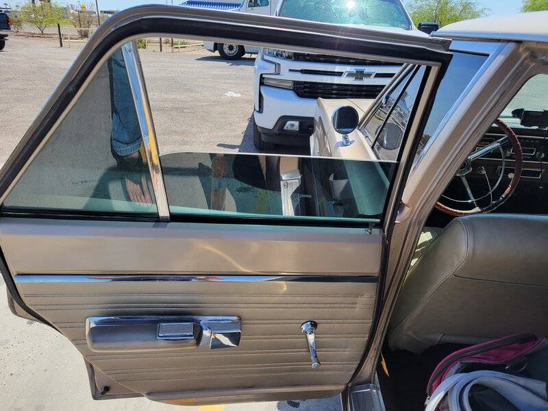

Quick question, I went to roll my rear windows down on my '67 Coronet. They ( both) only go down 1/2 way. I don't remember as a kid riding in the back seat if they went all the way down or not. Before I remove the panels, are they supposed to only go down 1/2 way? Thanks.

Here's where they both stop. They don't feel like they hit a "stop", but start to drag to a stop.

From the pic it looks like it could go all the way down.
I'd take that panel off.

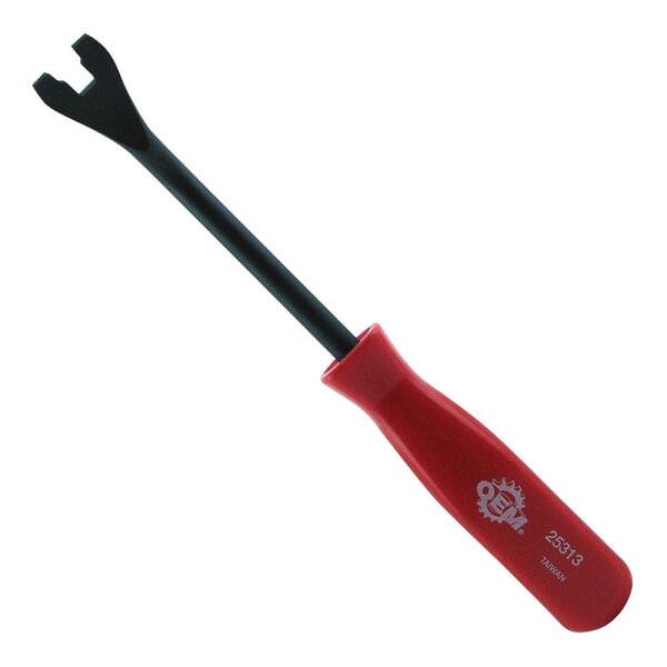

Get the proper tool.
Got the tools and now it's just getting my lazy butt out there. I replaced the rollers in my '68 Javelin, '74 Cougar, '76 Stepside so I'm pretty sure I'll figure it out. Just didn't want to tear into if I didn't need to. Thanks for all the hrlp.
