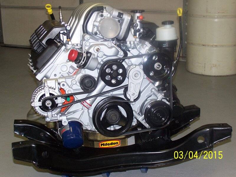

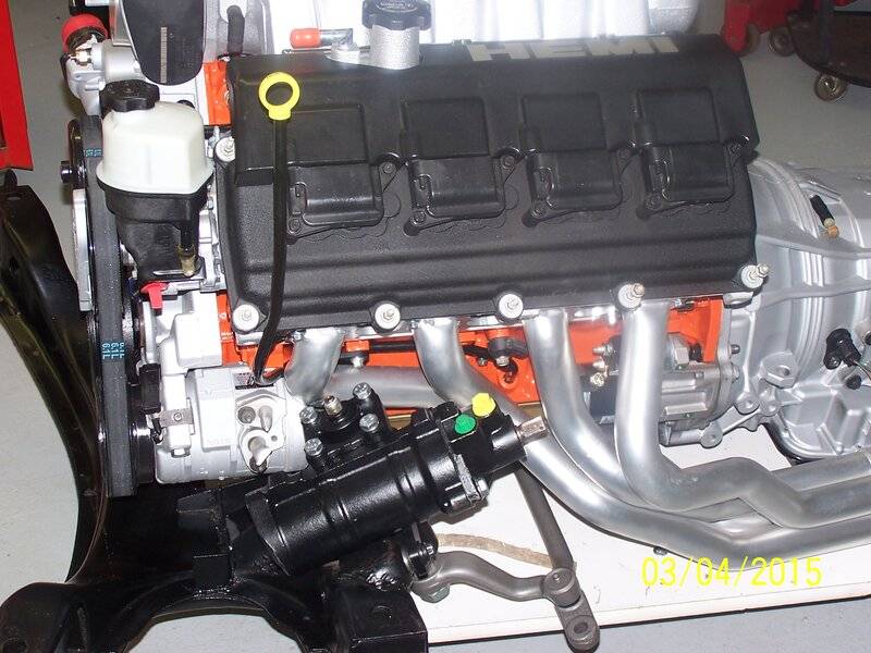

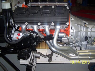

Not sure how much this will help but I installed a 6.1 in my 68 Charger a few years ago with the 06 SRT8 Alternator, and compressor. The PS pump was broken so I bought one from Bouchillon along with the pan, headers, engine mounts, etc. I used my factory AC box with the Gen III compressor. I purchased a new condenser and new expansion valve but used the old evaporator and heater box controls and R134. It works great. I used a gen III PS pump but upgraded to the Borgeson gear for a few reasons. 1. Pressure issues, 2. Header tubes hitting on the larger factory gear. 3. Better ratio. Here are a couple pics of my set-up.

That you very much, it is very helpful and gives me an excellent visualization of how everything lays out. I don't know if the 5.7 is identical but from what I see in your pictures and my own research it looks pretty close.
I really appreciate the information on the HVAC system, I would rather use the stock box and controls over a new system. I need to do more research on this subject.
