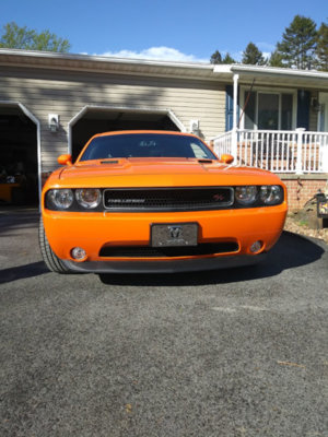

Ok SO I know a lot of you guys are running the 5.7 hemi engine. I just bought a 2012 Challenger Low miles ( my Next gen Dream car ) and being a Mechanic by trade and an X racer I HATE toe 5W30 oil used in these engines. I switched my 98 Ram over to 20W50 since New so my Question to you all is Can I switch the engine over to a Better Oil or am I locked in ?
Anyone running something other than this Lite oil ?
Any Help is good help so let me know
As Always Thanks Up Front !
