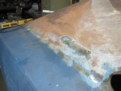

I welded up the holes for the trim on the vinyl top since I won't be going back with one.
http://s1284.beta.photobucket.com/user/daytonakid/media/68 charger/IMAG0901_zps6bfca255.jpg.html

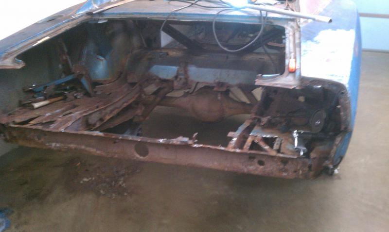

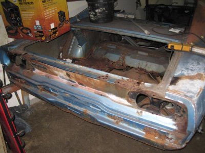

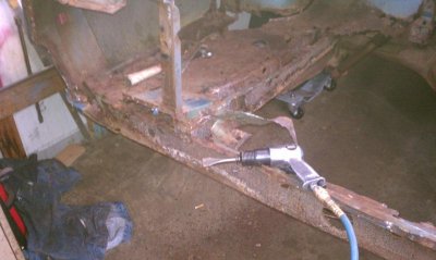

I have decided to hold off on putting the interior floor pans in due to my new plan of welding the 6x6 plates for the roll bar/s to the best spots and don't want the floor in the way while figuring that out. But I also don't want to put the roll bar in before putting it on the rotis. So I guess now I will have to fix the tail end (where it attaches to the rotis), because the last foot or so of the rear main rails is rusted out bad. I am planning on (in this order) inner reinforcing the bad areas of the rails with 2.5 ft or so of square tubing that I will weld inside them,. patching and skin-covering caps on them, while replacing the main tail-lite panel and it's lower valance, then mini tubing new wheel wells while side skinning the quarters, then replace trunk floor. I think if I do these different jobs one at a time that it may insure that nothing gets crooked or miss aligned. Does this sound like a good plan to you guys? If anyone has a better plan of attack or suggestions plz let me know.

Well after seeing hunt2elk's thread and how easy he made the wheel well repair look. I have decided to not do the mini tubs, for now anyway. I thought I needed new wells but it will be a lot easier to just repair the old ones like he did.. I ordered some full length rear frame rail caps. So I will prep for those and patch the old well edges now.
I would say as long as you are making sure everything is secure to avoid any misalignment then you are doing things in the right order. Everything looks like it is coming right along.

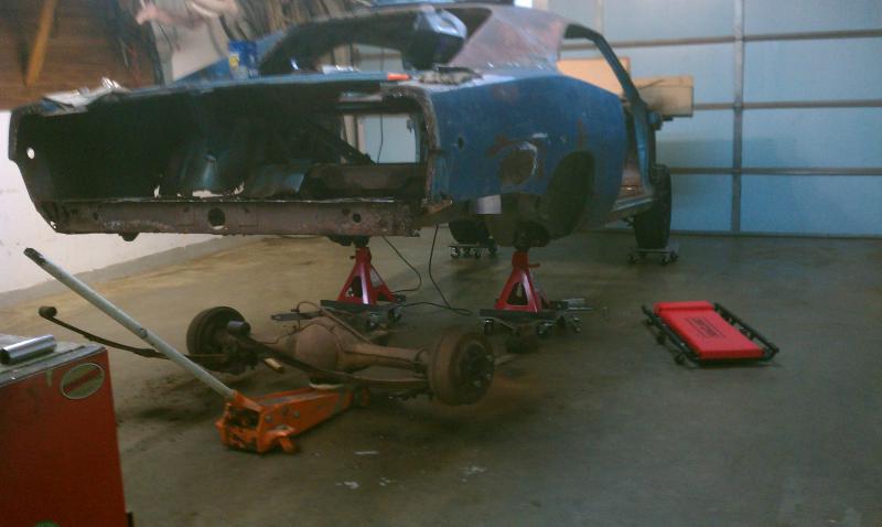

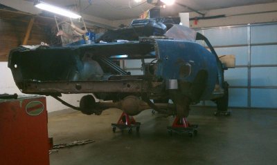

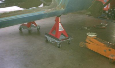

I removed the rear-end and springs. The work on the rear rails/trunk was making everything a little to flimsy,. will be adding temp bracing soon. Getting rid of all that weight seemed like the next thing to do. I wanted to leave wheels on as long as possible to keep it rollable but I guess I'll end up making a rollable dolly table stand out of some stout steel soon. My jackstand/dollys are good but I'd feel safer with it on something better. Rottis will come later. Will be removing K member and front end soon. Going to buy 2 more $35 big jackstands tomorrow to get the front end up.
