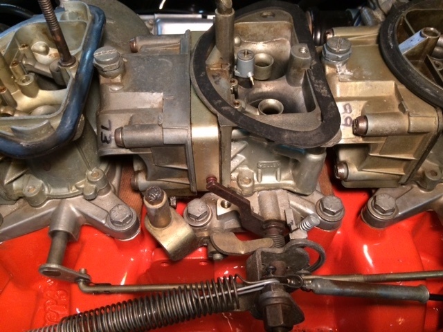

I've been running one on my RR for years. Bought the 500 new and cut the air cleaner ring to match the two bbl Holleys. You have to use the linkage from an original six pack center carb. I had an old, modified one that wasn't working very well. There are some differences, and my center carb uses quite a bit more jet than a stock six pack. I used the 500 out of cheapness...it was about $250 less than a center six bbl. I can check jet sizes if anyone cares.

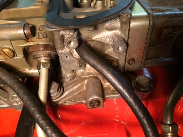

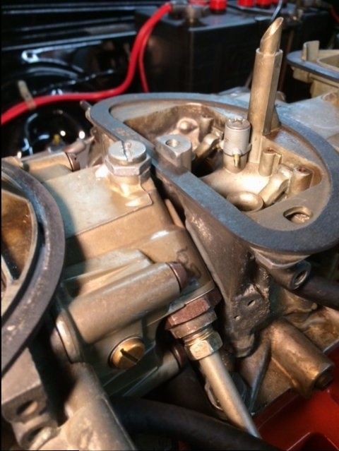

Here are some photos of the 500 on my car. I did not do the modifications. They were done by a friend of mine.

I honestly can't remember. If you're thinking about the vacuum hose barb that goes into the side of the body, I'm pretty sure we JB welded a tube into the side of the body. The biggest problem I had was with the hose for the PCV valve. It comes off the bottom/back of the carb. I used a 90 degree fitting, but needed to modify that as well to make the turn without hitting my rear carb bowls. Just had the car out for a ride. It drives great. No issues whatsoever. When the outboard carbs come in...it's a beautiful thing. HAPPY NEW YEAR to all!!
I just drilled a hole through the body into the venturi that was the proper size for a press fit for a 1/8" brake line. Worked great.
