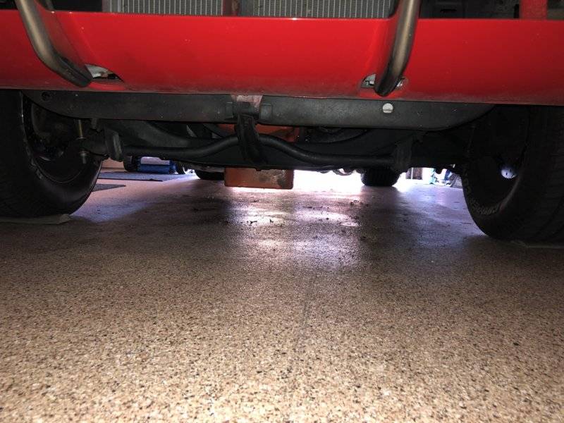

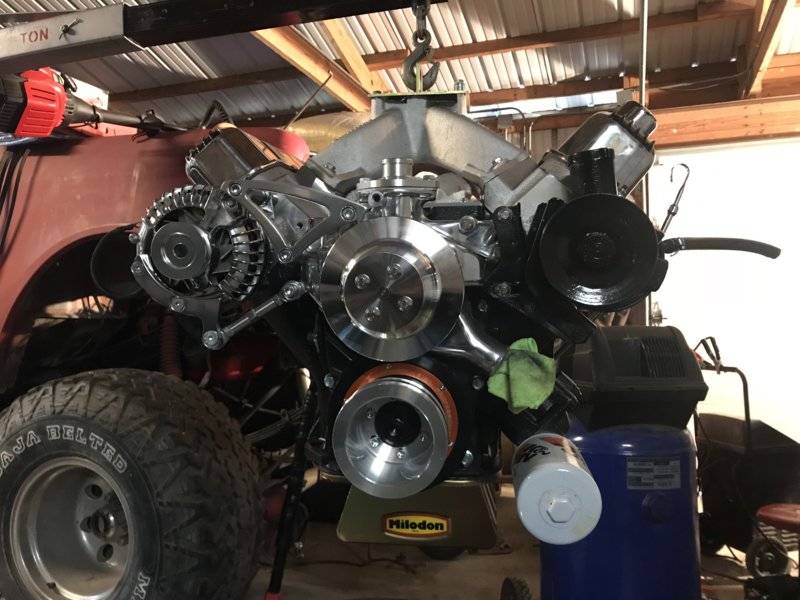

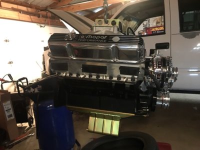

808B4EE5-B27C-40C9-933E-329461289F51.jpeg 20F74FC4-FE9E-438A-8910-CE734159EA4B.jpeg D1AA53DE-D2FA-4CD6-975C-3C3B0C7AE850.jpeg
7 in and 4.4 coming out after a couple hundred miles use is scary. I don’t know that pan but you’d think it would hold at least 6?

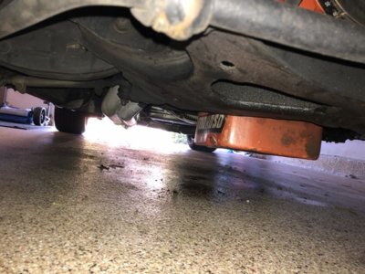

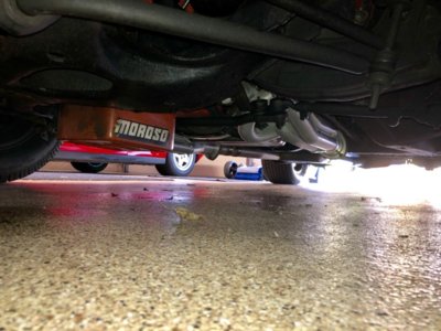

That’s at least a 6qt pan, looks similar to mine and it’s a 7qt. Are you running a windage tray?
9AB635B1-6655-46EC-86F5-5661B8AB18EA.jpeg F06B0D73-9453-4998-8ACE-AF3853BFD9EE.jpeg

the last time I did a fill test on one of those pans, IIRC, they more like 6qts than 7qts. the problem is the sump is short length wise. this lets the pan maker have a one size fits all. but, even at that I think your loosing oil some place. could be a leak, intake not sealing, rings, valve seals, etc. going down to 4-5qts is probably dangerous in a performance engine.

What crank is in it, if you know??
as others have said a windage tray is a mandatory part of a performance engine. i use that pan on my stroker and 8 quarts total with no problems. your stroker is bigger than mine if the builder of the engine did not under stand how much turbulence is in the oil pan just at 3500 rpms then i hope he did everything right.is the dip stick in all the way ? if you look at the pic of my car you will see the oil pan hang down it is black so look close.
