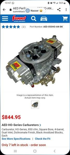

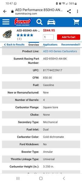

Well thanks for the help..Called tech dept at AED he was on par with a 850 like you guys said. Ordered the one in pics..damn thing is pricey hope it works well. Anyone here run one of these before.
Looks good. I notice they don't list what jet sizes are. Just curious. Let us know how it does for you.

I believe a 750 can handle 600hp..I called the tech line at AED he 850 would be perfect and the one I got has annular booster which probably drops it down to 830 cfm..I'm betting you would be close to same carb. Give them a call
