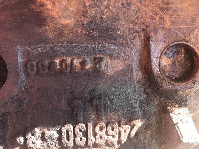

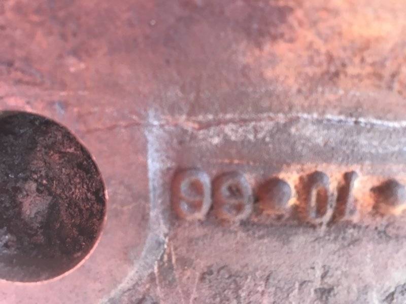

I really cant tell But since it goes from plug to plug Im pretty sure its a crack. Here are some pictures of the line in question. I first thought it was a heavy scratch.
Cast iron welding would do it and being in water jacket not alot of stress there
I have never had luck with a wire welder....I don't recommend even trying it...a block is 2 big. Stick welding can be done and not a big deal, or tig possibly. We get our rods from Muggy welding. Doing short stich's cold and letting it cool should work. Works great on heads and manifolds...I think a block could be done. Haven't tried a block yet with muggy's rods...but I would do my research on their site.

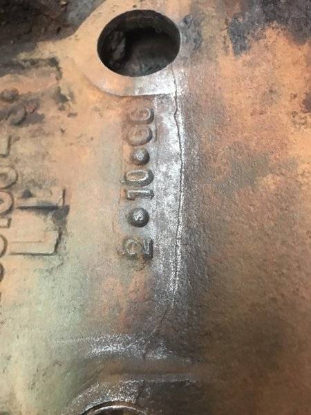

Cleaned it up with brake clean yesterday. Here is the result.
Check the cylinders closely too.....
I need to send the block to be cleaned and checked to make sure its atleast good to use. I need to check the bore size. I do believe its standard. Has a Maltese cross so I assume .001 undersized bearings. The cam might be no good but I would do new anyhow.
