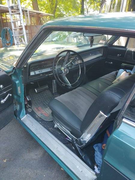

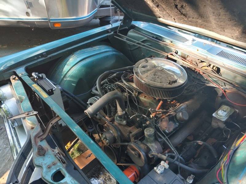

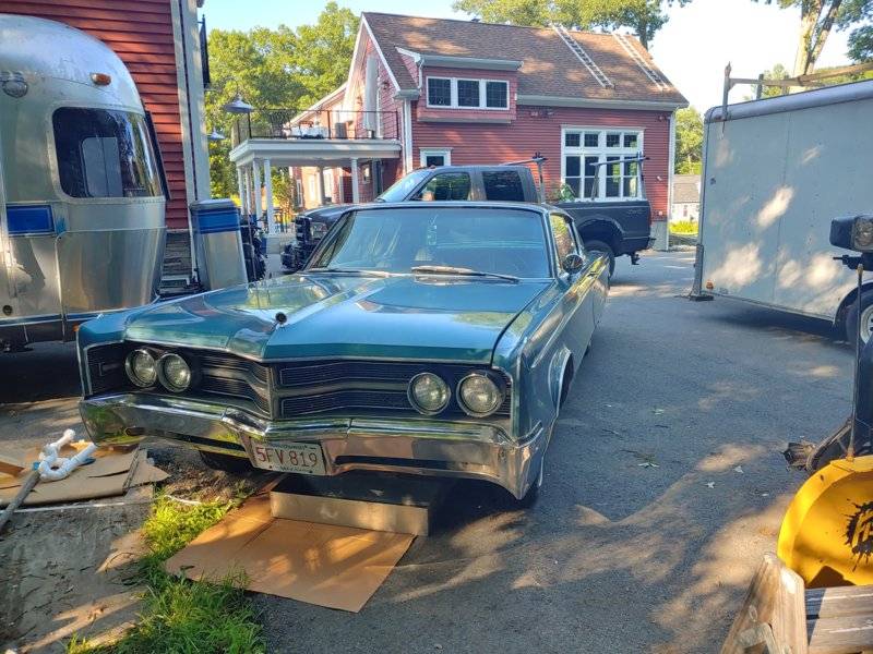

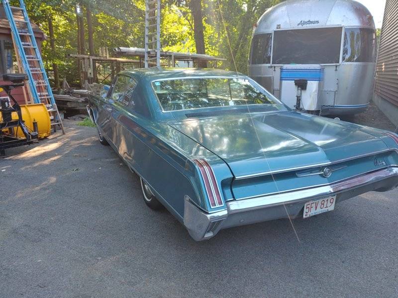

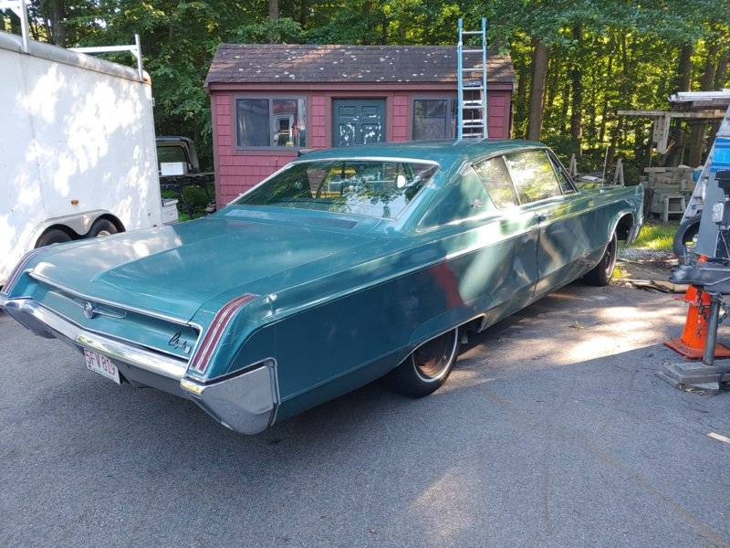

Im looking for some 14" 5 slot aluminum wheels for it. But otherwise its pretty stock. New front seat and i made a new exhaust. Its been re sprayed sometime during its life but im pretty sure im the third owner. It got passed down from its original owner to his son then i purchased it.
I have the original build sheet and the cericard somewhere.
I just installed an oil coller on it but other than that i just keep her running and drive her 2 miles to work everyday.
