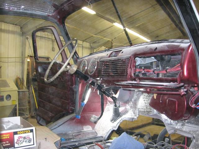

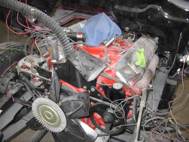

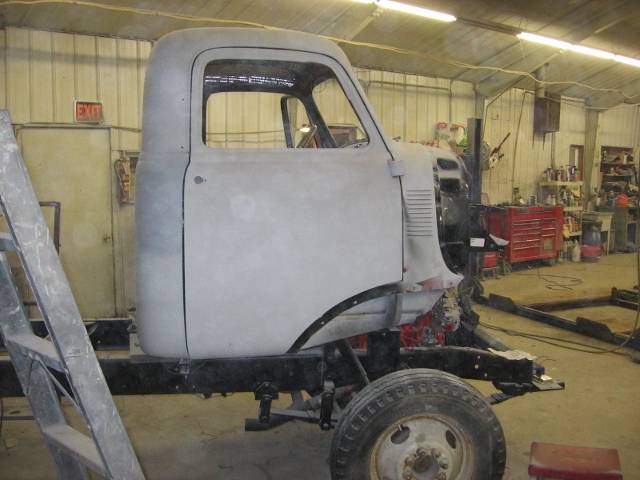

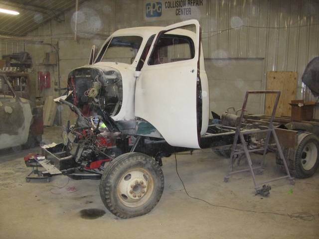

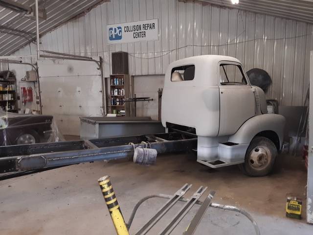

Just one of our shop projects, It will take some time as it just gets a few hrs here & there.
52 COE gmc on a 72 Winnie brave running gear.
we have a 20ft steel car hauler dove tail deck with frame and axel to graft onto the Winnie.
The 440 and 727 are 44,000 mile units and run great also will remain stone stock.
I will post up more pics as this goes along. Just thought mabey you guys would like a 440 in a GMC :lol:

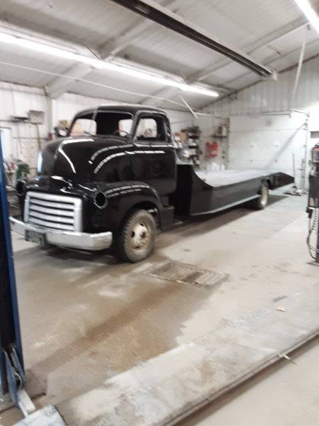

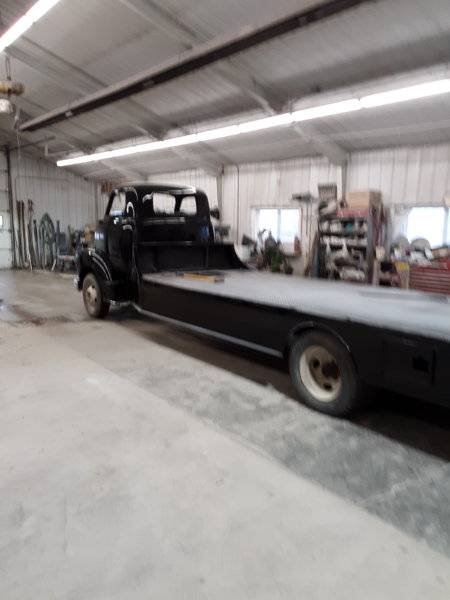

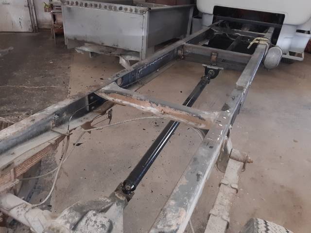

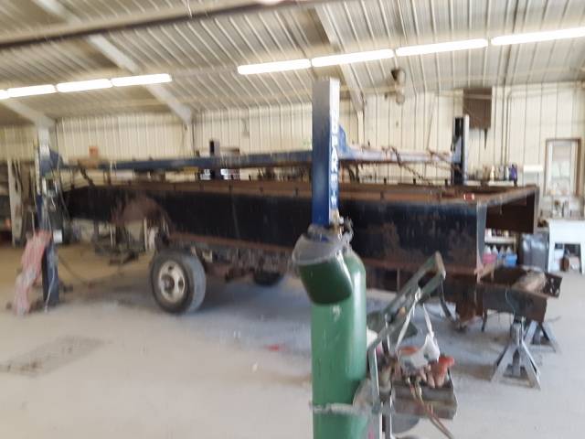

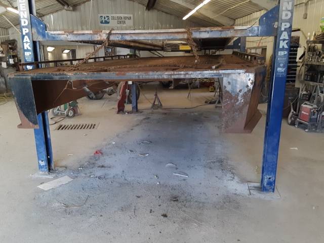

Made a little more progress on the 440 powered COE , did a 74 inch frame stretch got the drive shafts in, deck pulled of the old frame.
have to blast and epoxy the deck next. Slow but its coming along as we have time.

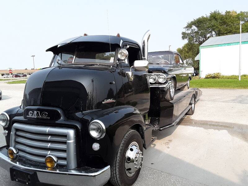

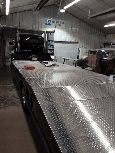

Getting near the end of this build . Still have to cover the deck with aluminum tread plate sheets and steps.
Sorry about the brand x on the deck lol. I was going to run my 67 on it but my brother wanted to see his black car on it.
Remember guys the heart of this old girl is a 440 and 727

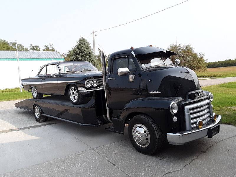

Small update, getting the aluminum diamond plate on. Also bought a pair of 7 ft. Alum ramps.
The 61 will load over the dove tail break . Very close though to the exhaust up front.
We placed a pair of 2x4 pieces under the ground end of the ramps.
That gained a little more room, prob will add a aluminum block under each ramp end.
