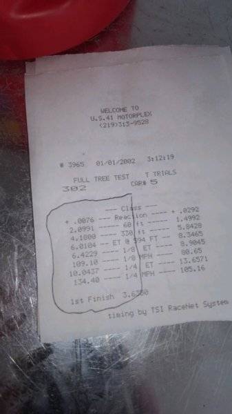

I built a 535 with a stock block for a local guy. We used a weiand six pack tunnel ram intake and made 685hp on the dyno. He’s changed over to a Dominator and Edelbrock intake and is easily well over 700 with that setup. It’s stock caps with a line hone. Keep the tune right and it’ll be fine. He drives the dogsnot out of it. Here’s his timeslip with a crappy 60ft. Once he gets the launch figured out, he’ll be deep in the nines.
BTW, I dyno’d it on 91 octane pump gas (the crappy ethanol blended pump junk,lol) and it’ll cruise on 87 all day long.
Refresh us on that build, that was a bad hombre.

TFS 240 heads, Molnar 4.500 Crank and Molnar H-beam rods, Diamond pistons 10.8CR, big Comp Hydraulic roller cam, Morel Hyd roller lifters. Stock block, 2” primary headers. Pump gas. It made nearly 700ft/lbs of torque and never went below 600 all through out the pull.
The 270 heads weren’t out yet or we would have used those.
