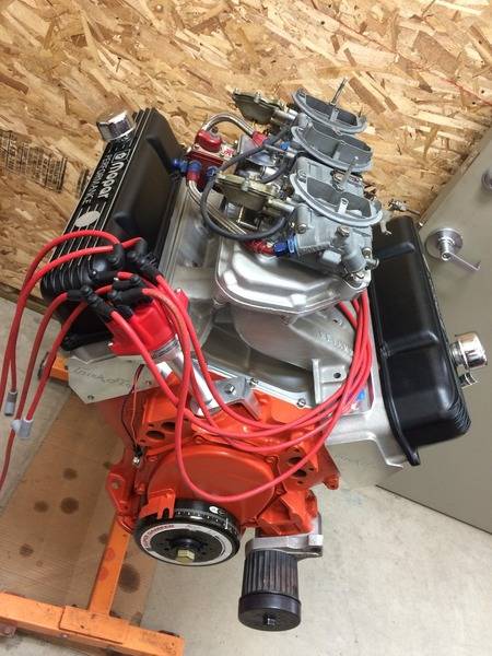

I hope it runs as good as it looks!!
Thanks Snake! I've never used these heads or one of these intakes and have only built a handfull of six pack inducted engines. This one will be anyone's guess when it hits the dyno.
I still need to add the elephant ear motor plates to it.
We should get a bet going on what it will make? Care to share cam specs?
For now, I'll just say it's a very large hydraulic roller, 10.75:1 CR, diamond pistons, 1/16 moly top ring, 1/16 reverse twist second and 3/16 oil. Typical street ring package. H-beam 6.800 rods and Molnar 4.500 crank.
Great looking eng for sure. It should fly ! Ron
:popcorn: Can't wait to see the hp/TQ I have the same heads and matching intake just can't afford to build a motor yet
My guess- 612hp/ 635ft-lb.
Yowsah, a 4.500 stroke will flip the car right on it's side!
It's gonna make torque with those cubes and stroke. Big hydraulic roller? Hmmm. I would think it will go over or close to 650 torque. Hp should be a bit better than that. It will be interesting to say the least.
Yeah 537ci 4.5" stroker will be a torque monster
she's a bute !!, if it runs 1/2 as good as it looks it'll be impressive
never tried the Weiand 6bbl long runner/tunnel Ram style manifold
Tried the STR 14 & 15 on a couple of different bb's
interesting to see/hear what it does
always loved 6bbl induction
