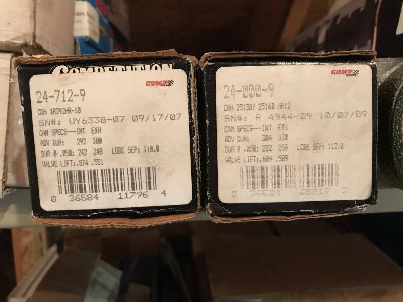

I have a couple new hydraulic roller cams that would work well. I would probably run solid rollers on them and set them up as tight lash cams.

Here’s the two hydraulic roller cams I have
