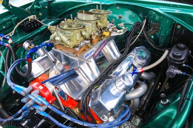

I've run the gamut of intakes that have a 3x2bbl capability, along with being able to match up to Max Wedge ports.
I have been steady on wanting to use my N96 hood that is on my car, and complete the Air Grabber setup.
All roads pointed to the Indy ModMan intake w/3x2bbl top.
I have been offered a Weiand P3690982 6bbl crossram intake, and I'm having a hard time saying no, in the face of the "aluminum shoebox" ModMan.
What say you guys?

the only way the weiand will fit is with the 4" 6pk scoop and I don't think you can use the 6pk air cleaner I've had this intake on my charger since 77
I understand that the Weiand 6bbl intake would need an A-12 style 6bbl hood scoop to work. I've tortured myself debating over this intake before.
I am going to call Wilson manifolds to see if they can make the ports match Max Wedge ports. I would be shocked if no one else has used one of these intakes and not opened up the runners to Max Wedge port size.
The Chrysler bulletin mods look like they have all been done on this intake.
The seller says he has the 3 500 CFM Holley mechanical carbs that are associated with the intake, and that they are "new". The Weiand can also be modded to accept the F&B 3x2 EFI/DPI/TB setup as well, like the Indy ModMan, but the injector bosses have to be welded in and drilled.
If I was going with the F&B setup from the get-go, the ModMan would be the best choice. I just have a fascination with the Weiand, and I think it may work better with carbs than the ModMan. What I don't know is if it's worth losing the N96 Air Grabber over, because I really like the look and function of the Air Grabber.
The sixpack weiand tunnel ram is the sexiest three two barrel manifold out there. It can most likely be modified to work with max wedge ports, especially if you modify for port injection. The question, which only YOU can answer, is do you want to change your hood (obviously save all the parts that go with it), and deal with the complicated tuning that supposedly comes with the weiand ram. I remember there were air dams and popsicle sticks glued into them to try and make the distribution work, but i dont know where that info is.

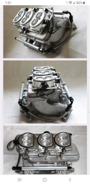

Maybe the solution is the fitech throttle body sixpack setup, i dont think that requires the port injection modification. Still, the mods that would have to be made to the weiand to get it to fit max wedge ports will lower the collector value of the manifold considerably. If you were willing to try to make the weiand work it would definately be an attention grabber!

As far as EFI goes, BOTH manifolds are compatible with the F&B 3x2 system, and BOTH look great setup that way, and the ModMan definitely works very well with EFI, and EFI on the Weiand fixes a lot of the inherent problems with it because the F&B system uses direct port injection, thus eliminating the fuel puddling issues.
I am going to use my Promax modded Holley carbs on whatever manifold I use, and keep the F&B EFI as a potential upgrade if I decide to do that in the future. It looks like the Weiand that I was offered, that has already been modified according to the tech bulletins, is no longer available due to a misunderstanding that frankly took me by surprise, in a manner that I am SMH about.

Uh, isn't there a difference between how a crossram and a tunnel ram might fit under a hood? Are we using the terms interchangeably?
With your 6-bbl desires you've kinda painted yourself into a corner. That is okay because that is what you want and it is understandable. The modman is like a tunnelram that has had it's legs cut off right at the hips. It is the only box stock thing that is going to fit your 6-bbl max wedge project. Is it a good intake manifold design? No! I've seen some pretty good engine builders at a dyno contest looking at the thing and just shaking their heads. But you can suck enough air through it to make some horsepower with 541 ci.
It is a back to the 1950's design like the twin log manifolds where we were using six Stromberg 97 carburetors.
How about a three deuces bolt on top ?
On an 8-71? Then you wouldn't need a hood!
No, it's the only 2 manifolds that are left for me to consider, for a 3x2 w/Max Wedge ports.
I actually discovered, researched, and asked AndyF directly about a 3x2 top plate on the Indy 440-25 but he stated it too would NOT fit under my hood.

See, that crossram style, that's some cool stuff if it fits maxwedge. Should be better than the Modman. The only thing I would use the Modman for is direct port injection and a blower.
IQ52 that weiand is an odd duck, feeds cylinders like a crossram, but has some of the height of a tunnel ram, with the carbs inline, and the distribution problems of what-the-heck? I loved it's looks when I first saw one on a sixpack super stocker, but when I heard about the tuning headaches, I forgot about it. Still sexy looking though. Expensive when you could get them new, now crazy money as a collector's item.
