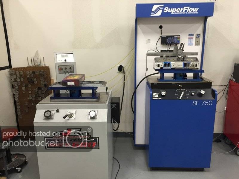

My bench is a Saenz S-600, which is basically a copy of a SF-600.
On my bench, if I flow a hemi head with the exhaust facing away from me, then turn the head around so it’s facing towards me, the flow numbers go up.
Adding a flow tube, which is like a short piece of header on the head, the flow picks up quite a bit.
For me, the turning the head around really seems to be more of a hemi head thing, since I’ve tried it on some other heads and saw no real difference.

Depending on how the flow tube was shaped, if the tube would fit on the head with the head mounted with the ex facing away from you, I don’t think turning the head around would do anything.
On my S-600, it seems the proximity of the rear “wall” on the bench to the Hemi exhaust port, and the way the port is facing, blowing the air into the corner where the base and rear wall meet, seems to create a poor environment for the column of air to exit the head.
Turning the head around on that type of bench allows for the port to have unrestricted flow.
Not all benches are built this way. Many of them don’t have the “wall”, and on those there wouldn’t be any benefit to reversing the head.
FWIW, IMO......the hemi ex port in particular really needs to be tested with a flow tube if you really want a good handle on what it flows.
As always........ ymmv....... but I don’t bother testing the ex ports on hemi heads without turning them around anymore, and I test both with and without the tube.

Some benches have the wall...... some don’t......
2E517BE8-4359-4BD8-BA82-15B478701973.png 13ED0C5F-598C-4335-8D81-39F2CF0E6761.jpeg 6F6DA431-AFE9-4D51-8BCF-766223F7D790.jpeg
PRHeads, That's interesting stuff. His flow bench defiantly has a back wall.
Would the fact that the Hemi head is a lot wider be the reason the wall effects the flow (the wall increases turbulence).
I think it’s the width of the head and the way the ex port aims down into the corner of the base and rear wall.
Whatever it is....... on hemi heads...... if I turn them around, the ex flows more.
