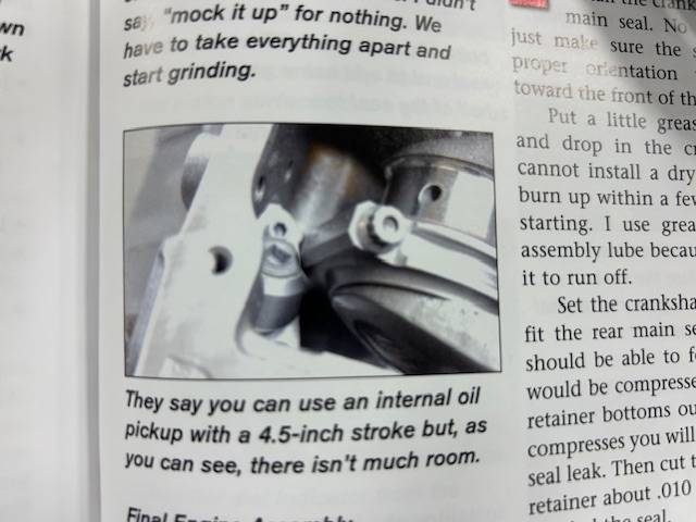

I've seen it done, but it's tight. Be prepared, you might have to fight to get the pickup to fit. As Dirty Harry would say, "do you feel lucky"?
This photo is from Rich Nedbal's book. The block appears to be a World Products cast iron.

That picture looks like it would hit the pickup tube, although it sounds like some people have it configured with the internal pick up.
Think I will buy the pickup and see if it fits in.
