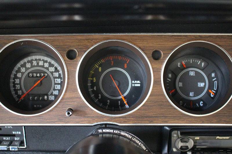

This tachometer shown on a 1971 Barracuda for sale has me mystified, a yellow band from 5,000 to 6,500 before it turns red.

Red is no - no land. Don't forget this car had 7 engine choices. And some were stick shift cars. 5k for the 383, somewhere around 6k for the 340...8 grand...uh no.
Was it on a Canada car? Could be a rarely heard about, even more rarely seen METRIC tach.
Sorry, couldn't help myself, I have no clue. I thought they were all the same but maybe they changed up the color bands during the later years?
I would think that a 6500 red line would have to be for a hemi, or a 340. But i don't think either ever had a factory rev limit that high.
Or somebody re-faced it.
I think I've seen others like that when I've been browsing cars for sale
