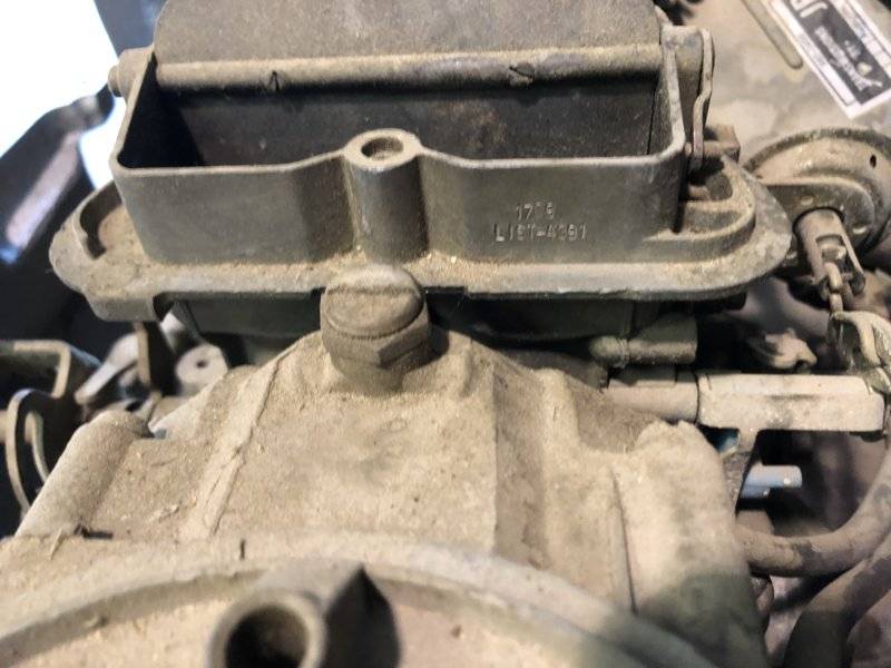

hello all, just curious if anyone can help me confirm? Or, get more confused I have a six pack set up and all the research I have done says it’s a 440 manual trans A12 center carb. Any help, would be greatly appreciated. Thanks.
According to the Promax site,
1969 440 manual trans. center carb.
http://www.promaxcarbs.com/
I sent them my 440 6bbl setup that was running good, but I wanted to get their throttle plate w/angled idle mixture screws for the rear carb, their jetable metering plates for the outboard carbs, and their advanced metering block for the center carb. I also had a stripped screw hole in the accelerator pump housing on the center carb that was holding, but it needed to be repaired for peace of mind. I also got the lower and upper stainless steel braided fuel lines w/inline reusable fuel filter and pressure gauge.
