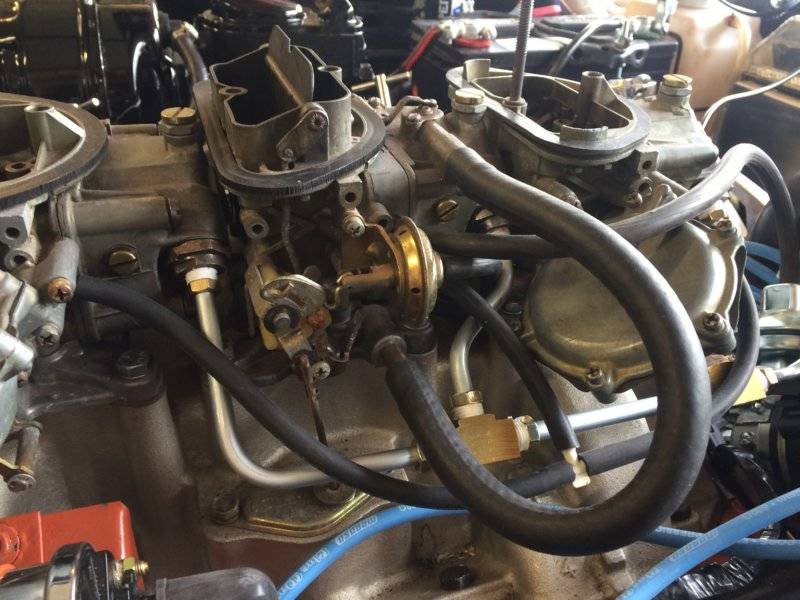

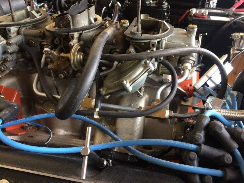

You guys were dead on! Capped all vacuum ports and engine now idles fine. Please look at photos and let me know if vacuum connections are correct if you would. On the larger hose looped from bottom of carburetor to top I have seen a numb Uber of different ways. Also I have my PCV hooked up to the air cleaner?

ok, first off why is your pcv hooked to the air cleaner? In order to work, it needs vacuum and should be hooked to the large port off the throttle base
the large hose on the top is just a vent, leave it open
the port on the bottom of the center carb is full manifold vacuum and goes to the choke pulloff dashpot
the ONLY port coming from the metering block is for spark advance so it goes to the distributor (assuming you use vac advance and I hook mine to manifold vacuum, but 1 discussion at a time) LOL
that leaves only one open port, it is tight behind the choke pulloff dashpot and this is the one that splits and operates the diaphrams on the 2 outboards
Based on what I can tell from the pictures, it looks like you are plumbed right except for the pcv and vent being connected. You need to fix that
