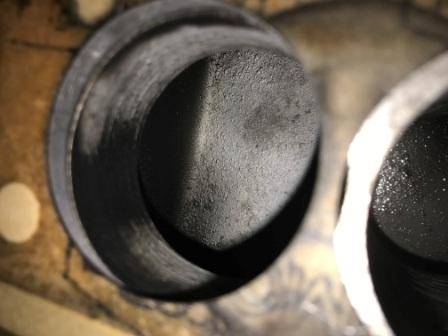

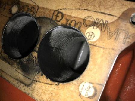

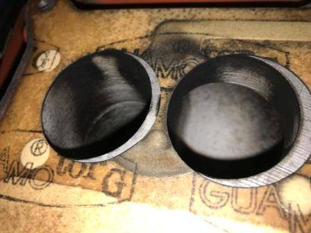

I've been having a lot of problems with plug fouling lately and after a lot of trial and error trying to adjust timing and idle mixer, I decided to pull the carbs to inspect them. I pulled the center carb and you can see in the pictures all the carbon in the intake manifold. Also the lower plenum is pretty wet, the upper one seems dry. Any thoughts on what's going on here?
First thing to check is float level. The gasket looks kind of funky, offset and looks like kind of an eyebrow on the bottom pic. Are the gaskets directional? I would not be happy with it.
Float levels are good. Gaskets are okay, they are just slid over a bit in the pic. I took the carbs apart and they look really good, although I have 64 jets in the center carb and 82 in the outboards. I might change the center to 62 and 81 for the outboard carbs.

The backfire may have broken the power valve. Normally looks like float level. Try opening the end carbs a tiny bit. But I have no experience with the mechanical end carbs.

Clean out your air bleeds. A clogged one will cause dripping out the venturi causing a wet plenum and rich idling
The end carbs do not have replaceable jets...they have metering plates UNLESS you've changed to the PROMAX conversion units. Also look for a leaking power valve gasket or bad power valve diaphragm in the center carb. I run my carb float levels "slightly" below the sight port threads.....helps with percolation.
