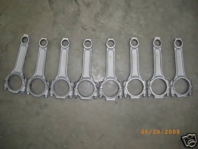

Do these appear to be 6 pack rods? They look beefier than std.
No reason to use the six pack rods. My (ex) Six Pack Challenger made 419 to the rear wheels and didn't run them
I thinik you have to have your engine exterally balanced for true 6 pack rods.
I have read somewhere that you need a larger than normal balancer...The rods, if purchased would be hung on a forged crank.
I don't know the weight difference between 6 pack rods vs stock but consider this: How many scattered 440's are there as a result of six pack rods? Didn't Sox and Martin (and others) race these engines? Now if you shift at 7500 RPM then you may have a problem, but for a street engine with shift points at 6000 RPM max I'd say use whatever you want. Personally, I think the best production rod to use is the OE 64 Max Wedge type or the early Max/300J rod. Same beam as the 440 but lots more material around the parting line to minimize deflection at high RPM. Seems to be a good balance of weight and strength. Now good luck finding a set. I'd stick to a properly prepared set of OEM's. I just got a set of LY rods resized with new bolts for about $275.00, which is about half price of aftermarket.

Hey 66, you can use the the stock YL rod with out any problems. Have them mag-ed or x-ray-ed for stress cracks. There are several aftermarket suppliers selling NEW YL type rods for low cost on ebay or other sites. The big advantage to the standard or YL type or aftermarket rods is low weight allowing internal ballance. If you use reconditioned Rods use new fastners always. you could have the beams polished and the small end bushed dependent on your application. Let your builder ballance the whole assembly out.

the 70-71 440 hp are externally balanced 6 pack rods
72 up 440 hp are neutral balanced with 6 pack rods
6 pack rods can be used in an internally balanced engine....but you can't just throw them into an engine that's been internally balanced using the smaller rods. Any time you make a weight change, a rebalance is in order. And I balance my rods and pistons before taking the rest of the junk to my machinist. Makes his job easier and a happy machinist is always good :D 6 pack rods can be made to work well but the LY rods do just as good when using a light weight piston. Heavy pistons is what kills rods....
