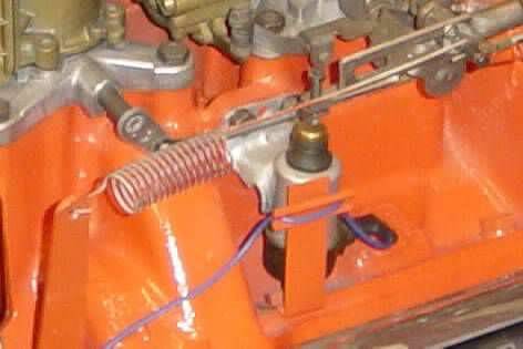

For the slow return to idle does the car have the stock dashpot on it - a canister/spring affair on a bracket that has a plunger that hit the center carb throttle linkage? It would be on the driver side and sit below the car close to the intake. I think they were stock on some or all six pack intakes. But that was their purpose - to slow the return to idle. If it's too aggressive it can be adjusted - even to the point of disabling it.
i think you are referring to the idle solenoid that deactivates on shut down to completely close throttle plates to help with stopping dieseling. used mostly for stock appearing setups. as far as i know it does not ease the throttle back to idle. it is used instead of the idle speed screw.
Hi Mac. You're correct it doesn't have anything to do with the throttle crispness or returning slowly back to idle .yes mine has it and that isn't an issue. I'm getting ready to get the distributor apart and check what's inside. I'm not sating this isn't the problem but I think my issue is more towards a vacuum leak I can't find or something out of adjustment with the carbs. But as before I'm gonna check everything mentioned by you all because I sick of not having a snapping running engine. It runs great, starts good, definitely plenty of power and outers open up nice at speed. It's just this slow idle return that is annoying.
