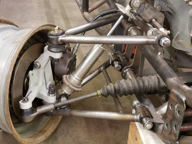

I'm also running Ford Pinto spindles.
So did this guy....
