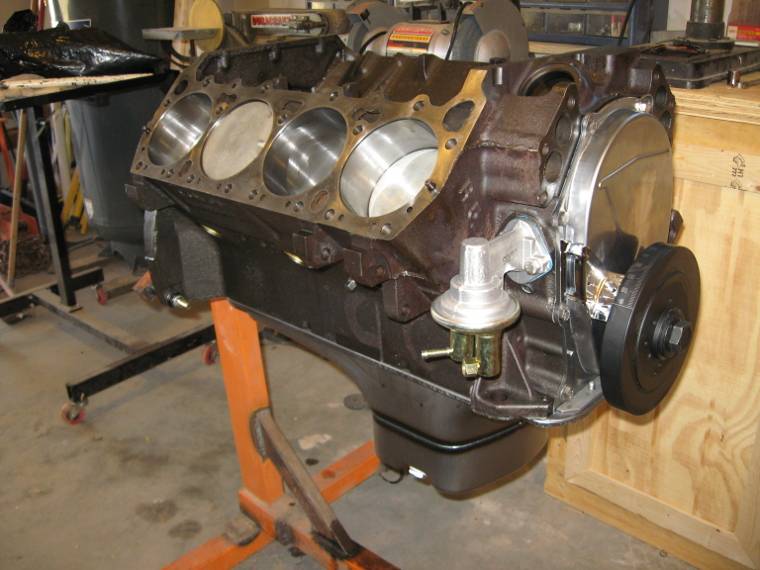

I wanted to share this info in case it saves anyone some time and money, I searched for a while when putting together a 440 for a 65 SAT and never got a definitive answer.
The 440 source 6 qt hemi pan DOES NOT FIT. It doesn't even come close.

It wasn't surprising and I'm not sorry about it either, it needed to be tried and I needed to share that it 100% does not work, because no one else had.
I won't share a bad review about it either, because it is advertised as E body and 'anything else you can make work' .... so that wouldn't be very fair. If they have a positive review or a shared experience thing then sure I'll go let them know. Mostly I'll just hope a google search turns up this page if anyone goes down the 62-5 road with the same idea.
Ironically it was a forum member that recommended the 440 Source oil pan to begin with.

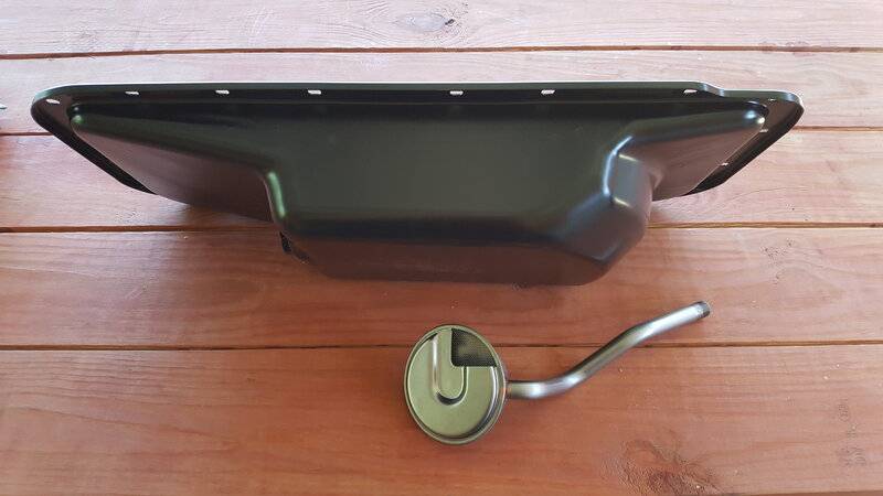

Here’s the repop maxie pan. IIRC, ~$300 on fleaBay.

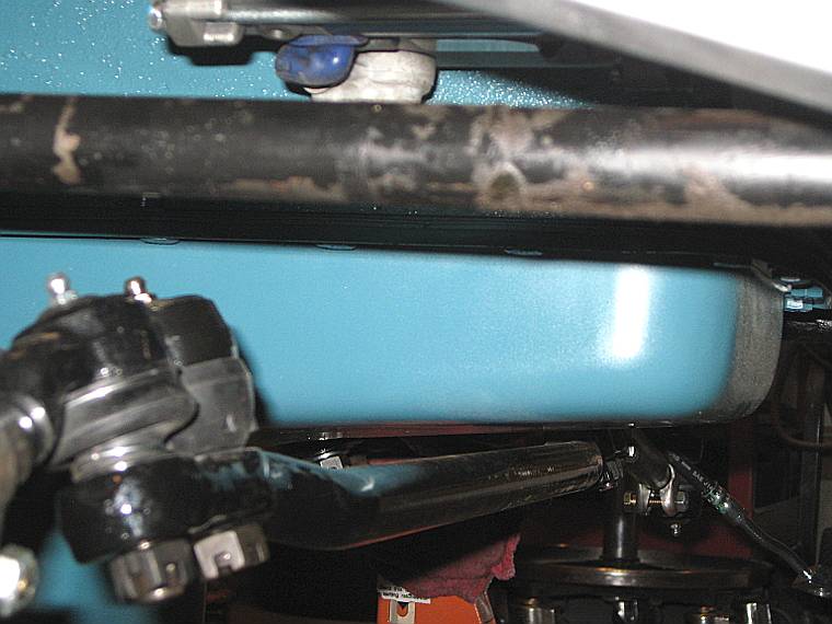

I used the 440 Source 7 quart pan. It fit fine in my '64 Polara with just a couple little (quarter sized) notches taken out of the "K" member for clearance. It hangs down a couple inches below the "K" member but ground clearance is still enough to take on just about any speed bump. Steering clearance is tight but still more than adequate.
