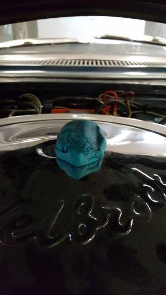

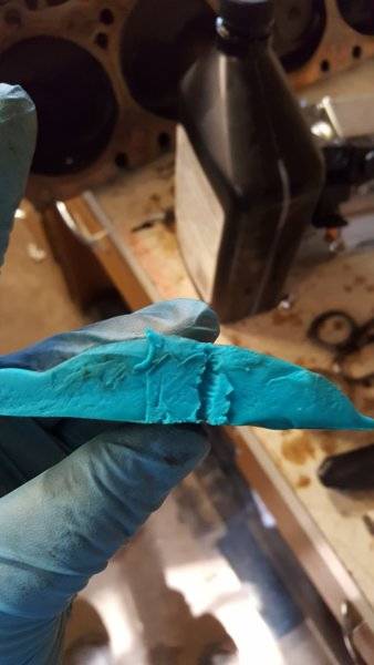

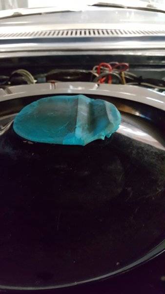

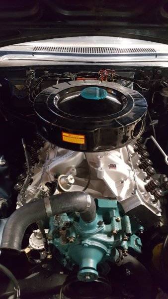

My RB has a 64 stock hood and RPM intake. It is close,even with the drop 3" filter but fits. I used playdough to check clearance.

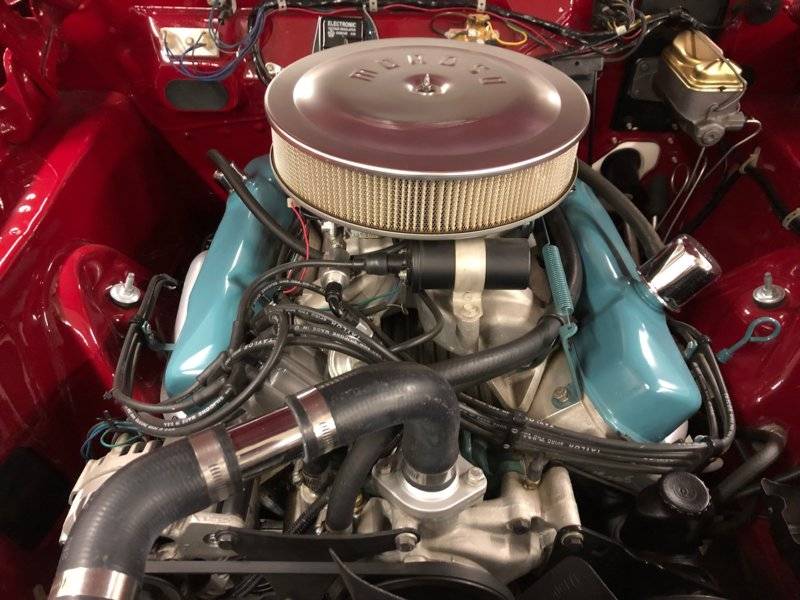

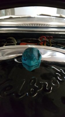

here's a few pics when I was mocking it up with a stock filter and then a cheap eddy, with the eddy carb on a 3/8" phenolic spacer. A low deck should be no problem. I have a Holley carb on it now, no spacer and could run a 3.5" or maybe a 4" filter.

65 Belvedere, 383 block, Edelbrock heads, Performer RPM intake, Edelbrock 800, Moroso drop base air cleaner. Plenty of clearance.
