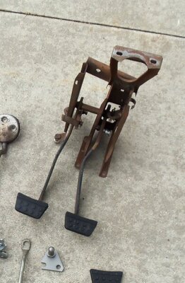

Clutch/ brake pedal assembly, torque shaft, rods, fork and fork pivot (62-65)Brewers

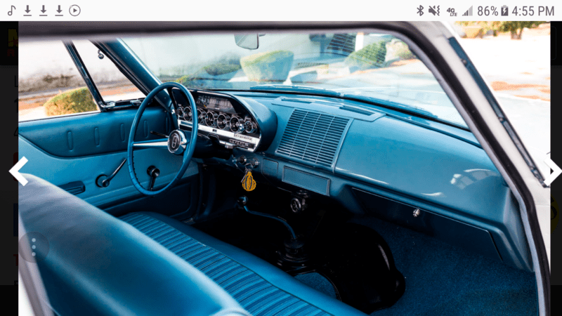

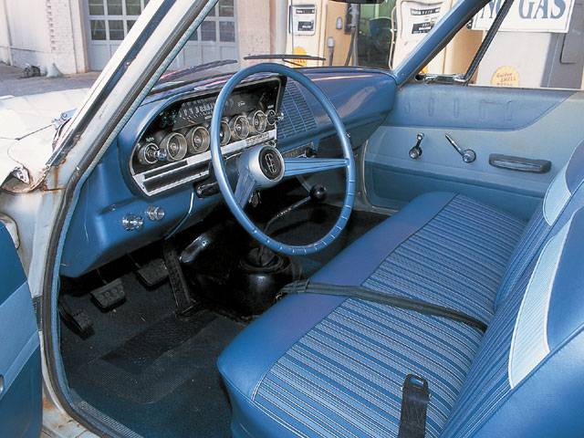

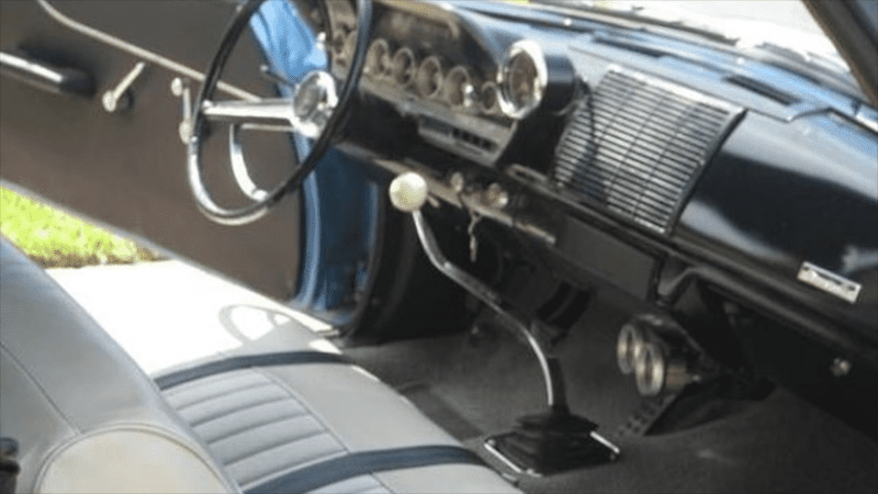

Any of you awake people have a pic of a 4 speed shifter installed with a bench?
Or know if the hump is specific to a year, or even needed?

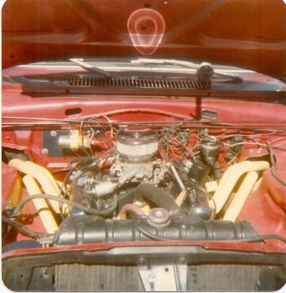

I recommend a firewall brace. I ran one from one of the master cylinder bolts to the shock tower. In the foto you can just barely see it (a black tube right below the master cylinder on the right) going behind the fenderwell header.

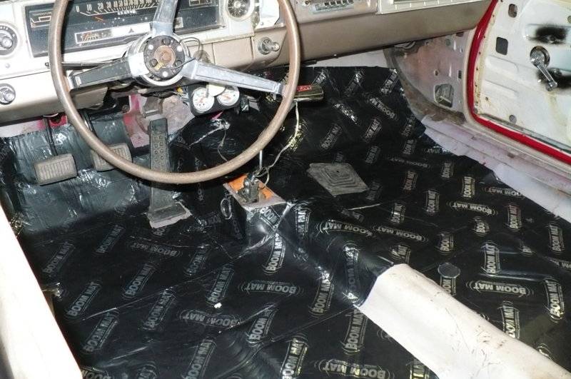

My other question is the 4 speed floor hump, is this really necessary?
I've seen original cars with it over the carpet, and it isn't small and it wraps over the tunnel to the passenger side, but my understanding is those are not the same trans/shifter as mine.
Also, new carpets are listed for manual or auto, so are they really covering that big hump with carpet?
I can't imagine the shifter will sit that high, and the one pic I found of a 62 4 speed with the carpet over it, looks smaller and flatter than the 'correct' hump.

Did my 65 without a factory hump My engine is set back an inch or so. I'd do the factory hump, bolting trans in or I think would be easier. Did mine to
tight to shifter and removed shifter 1/8 turn of one bolt at a time. Drilled a hole in side of hump to put that bolt in and used a body plug to cover hole.
Is that a diy hump?
I've done a few 4 speed conversions in the past and the boot would just be at an angle on the side of the tunnel.
It's hard to justify $250 smackers for a hump that looks like overkill, because it is, and it's supposed to go over the carpet, and really just for those max wedge clones.
Check out how the factory did the tunnel on the original floor-shift '62.
DYI hump yes. Pulled trans to change front bearing retainer seal. Lowered engine so oil pan was just off cross link to remove upper trans bolts. Set engine back an inch or so that inch or so engine set back made it a bear to clear trans crossmember to remove trans. That's the problem with homemade engine mounts. Made pattern of 66 hemi k frame mount and welded them to the k frame in my 65 which moves the motor back causing issues.
that first pictured hump look more like what is stock on the miser series Dodge pickup trucks of late70s early 80s that utilized the A833 OD setup
