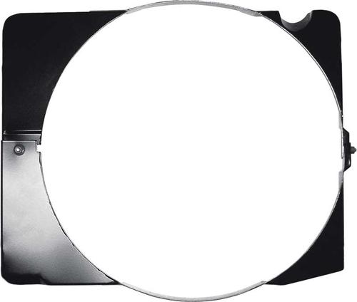

I'm curious what others are using for a fan and shroud on their Darts with a big block. I have a 413 and an aluminum 26" radiator from AutoCity Classics. I had a shroud that was on the previous factory radiator that the last owner zip tied on but the shroud broke. Fan wise, it has an aftermarket 5 blade fan, no clutch. At idle it'll reach about 210 in mid 80's temps. I want to put a stock fan and shroud on but I'm not 100% sure what will fit this setup.

I don't remember any stock shrouds on 62's.
For factory 22" radiator.
https://www.classicindustries.com/product/mb2337.html
