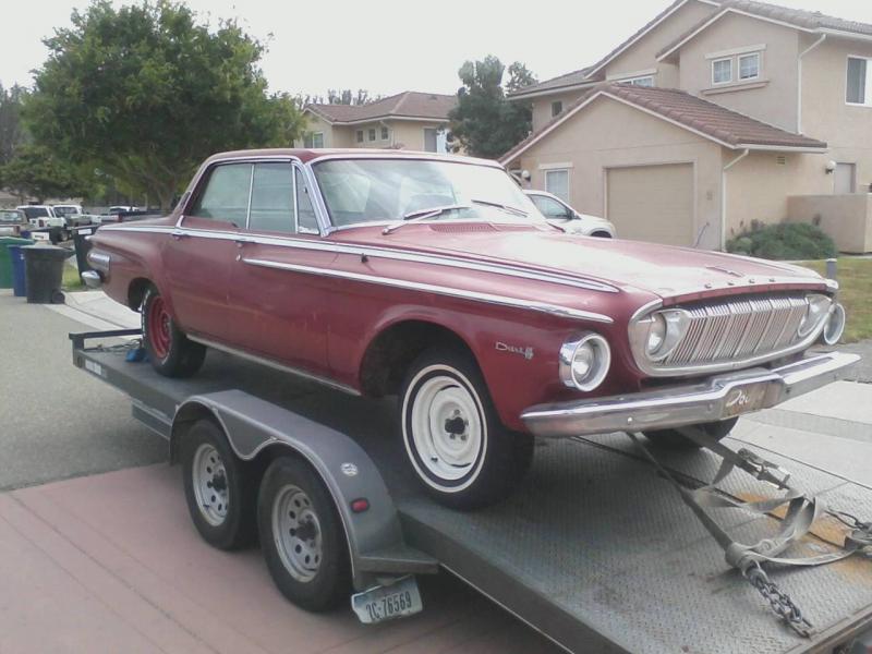

So the story begins with my brother getting out of the military. He wanted to build a fast car and was not too particular about what it was exactly. This 62 dart showed up for $1400. It had minor rust on the exterior, no motor or trans, V8 k member, limited slip 8 3/4 rear end, and the floorboards were gone. Really a solid car for what we wanted.
At this point people start asking for pics, sometime soon, promise.

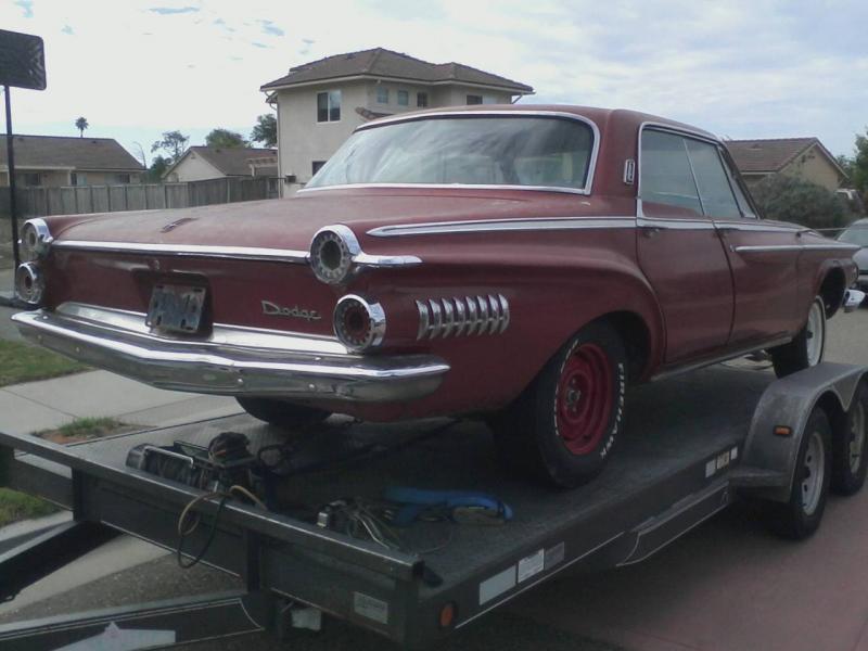

This is how it looked the day we got it.
Good job going with the Hydro booster that what I have on my 62 polara lots of brake.
I also have a 440 only with a 727 in mine need any info just ask.
What a beautiful car!
Darn: Interior is sweet and body looks great.

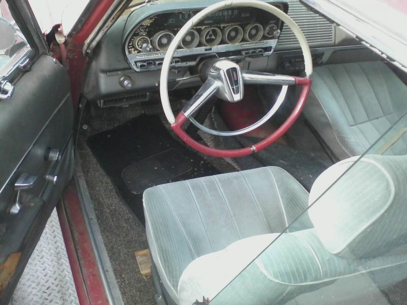

@super-bee_ski, the interior is pretty cruddy except for the dash. Carpet was trash, headliner is gone, seats are wrong and mounted on wood, door panels are only fair. We are getting a bench seat and new carpet over mass loaded vinyl.

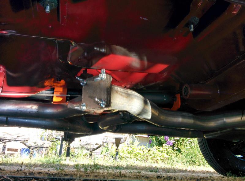

Exhaust
Reproduction Max Wedge cast iron manifolds paired up with an Accurate Exhaust Max Wedge system.
(H pipe and knock off plates)

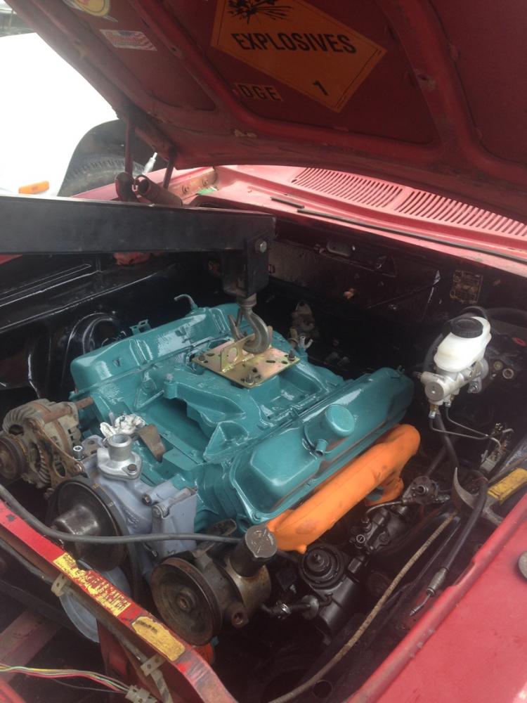

I hate waiting for parts. We have 15+ boxes on the way but of course nothing is here. Got paint on the engine though. Original (to the '67 block) turquoise.
Hey, anyone actually run a toploader behind a dodge? I am having some heartache over the length of the input shaft.

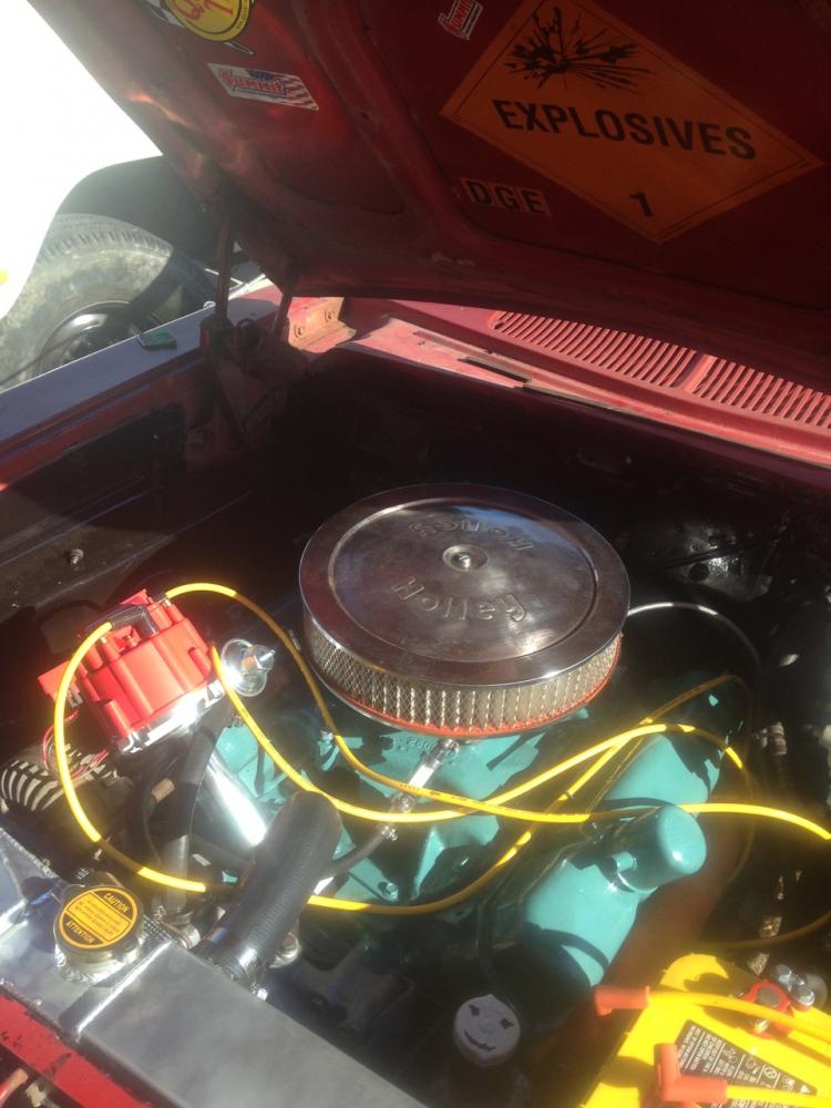

So we got a bit more done. Decided to resell the toploader and upgrade to a Tremec. Probably makes more sense in the long run. The engine is resealed and painted. Finally got an HEI to fit. Carb is on and hooked up. Rebuilt steering gear is in. We went with a 3 core aluminum radiator out of a 65 coronet. I started it on ether for about 2 seconds to verify the timing isn't 180 degrees out (it isn't). For all the pain in the neck HEI's start really nice.

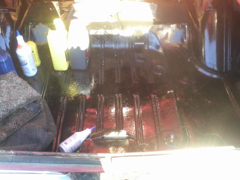

Here is the trunk pan. There are small rust holes but over all it is solid

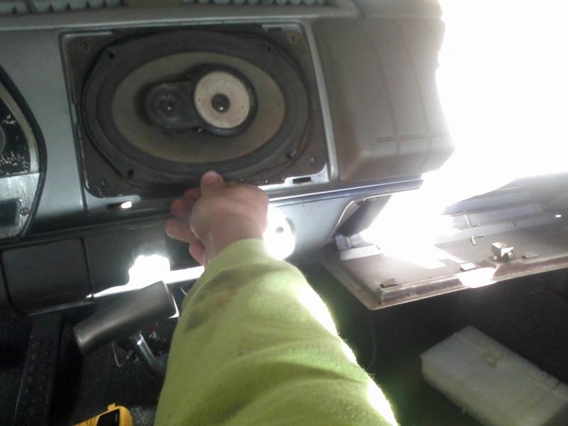

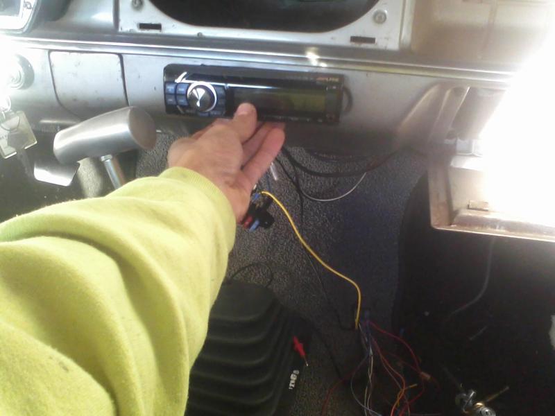

New speaker mocked in. The PO cut a hole in the dash for a radio so we will be putting in an Alpine single din radio.

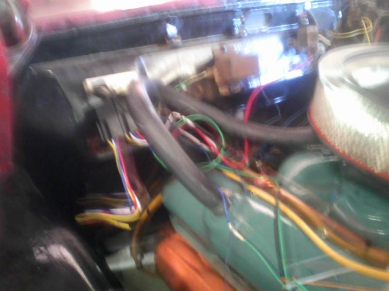

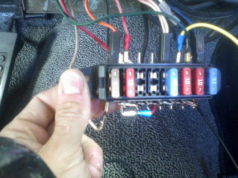

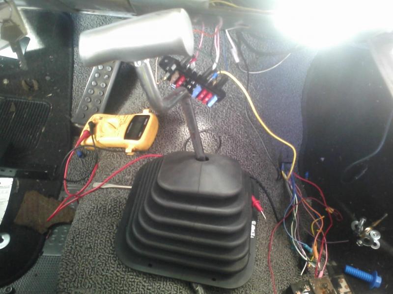

I wanted modern, blade type fuses. The old wiring was in rough shape so I swapped it out.

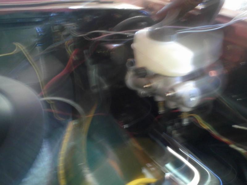

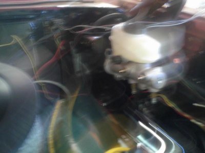

Here is the S-10 clutch master installed. It has some angle to begin with but I had to make a spacer to get the angle all the way right.

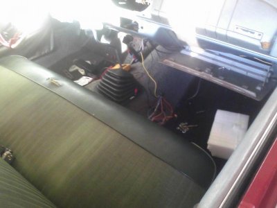

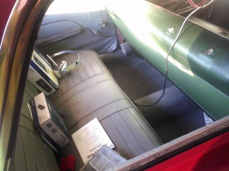

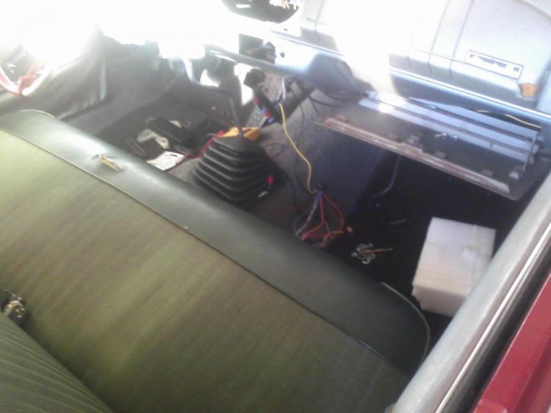

Interior shot. Pardon the mess. The seat was in perfect shape but we tore it putting it in (FML). It came with the car but it is green.

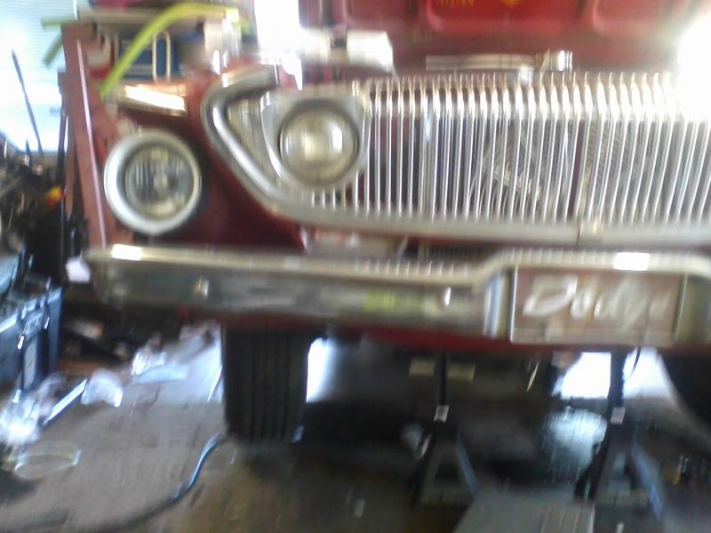

Sorry the pic is a little blurry. Outer lights are white halogen H4's. Inners are stock.
Hard to see but we put in headlight relays.

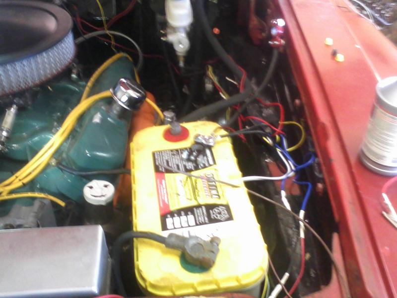

Fan and horn relays

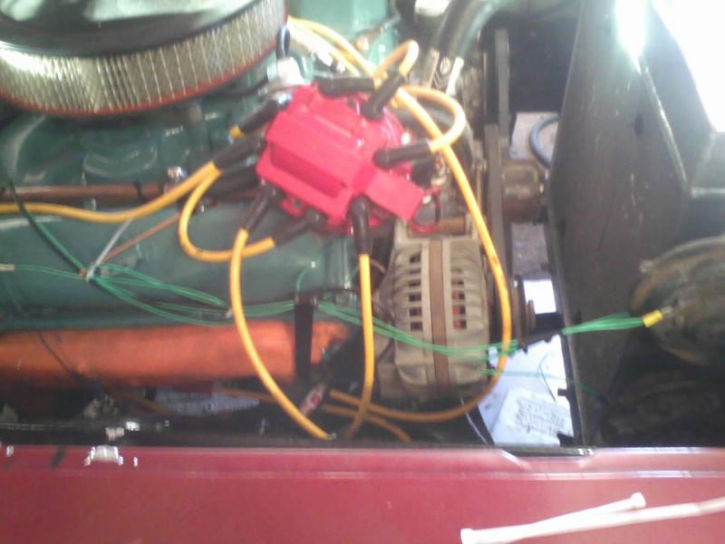

Here is our HEI distributor. Had to dent the valve covers to run it.

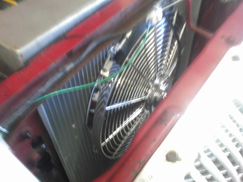

Electric pusher fan. It is on a 185 degree thermal switch.

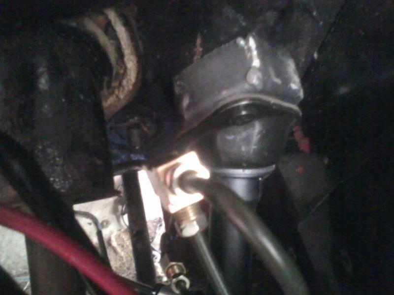

We have the brakes finished and bled in. We haven't tested the hydroboost because we haven't run the engine but it is all in.
We still have to finish some of the wiring and wrap it. It is messy now but should clean up nice.
Next up is exhaust. We will be going true duals, no-crossover, 2.5" to flowmaster 40's to 3" dump just in front of the rear axle. We got the flowmaster's used for $25 but my exhaust guy doesn't want to try to fit 3" under the car because of how small it is and how full the Tremec makes it.
