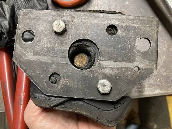

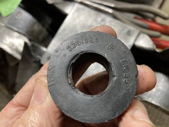

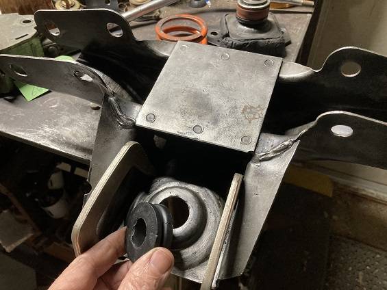

Any one here replace the grommet in one of these. I'm assuming it goes in and strattles the hole as the term "grommet" means to me..It's a tough little bugger as is and takes a big pair of channel lock to even think about getting it started. Tomorrow I'll try to heat it in hot water and maybe be more limber and collapse itself of it's own hole and go in. We'll see. Is that how you went about it or is there
a better way or a better tool I'm not thinking off.

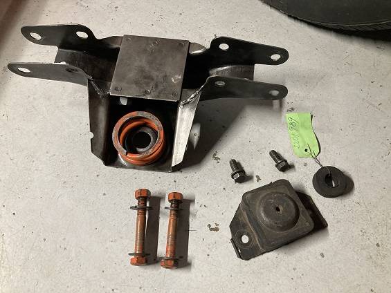

Getting back around to this project where I left off ~ 25 yrs ago. Back then the old grommet was tore in half at the thin mid point and I used it that way all sandwiched to gather. That's the old one in the background in pic 2 with what ever I had at the time to conglomerate it together.

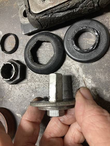

I wish i had changed mine to a different style, never knew these existed til i got my 62.. BTW.. can you show me the bolt that goes through that grommet? mine is just a bolt with like 2 built on washers and looks like it should have rubber in between them as it has like 1" of room to move around in the rubber on the crossmember. I haven't been able to find any information on this mount at all..

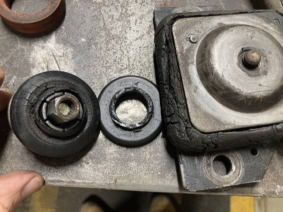

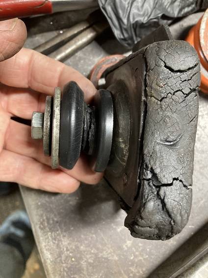

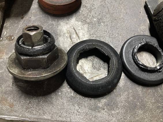

The original bolt was gone when I got the car back in 92. This is what was on it when I got it. Some one ran a bolt down from the top mount into the threaded plate and left a little protrusion for the coupler nut shown. Not much thread to work with but was enough that it worked for me about 3 yrs in the late 90's with no issues. They also tied the top and bottom plates together with 2 bolts for what appears the rubber mount was deteriorating. Not a bad idea, somebody worked with what they had.
I think I added 2 orange tuff rubber rings (pic coming later) to replace the lower broken half of the grommet. ...Faint memory coming back...think I ran 1 under the cross member, try'n to find the pic for that tho.
Appears the big nut was added to center the lower half of the grommet and wore a hex in it.
P.S. The grommet seems to be a bump stop for if the spring was to fully collapse.
The original bolt wasn't a whole lot different than what both of you are showing... Been 45+ years since I had my hands on one but it was basically a shoulder bolt with a made on washer
Thanks, i have the stock bolt, just had no idea what was supposed to be on it as all the rubber was gone.. will just make something up :)

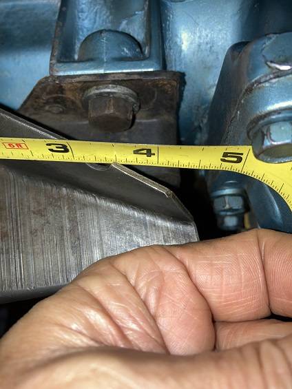

I've been curious about that myself not that I'll change mine over, I think it's a cool looking setup, different, but I'll measure the the center of the trans bolts to the front edge of the cross member for comparison.

Mine measured about 3-1/2" from the front edge of it's own cross member.
