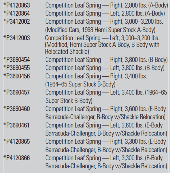

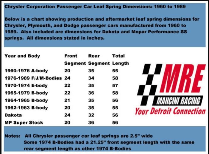

I am wondering if you have made any decisions on your leaf spring replacement. I am looking at doing this on a 62 Fury. Here is information relevant to doing so. I know relocation mounts can also be used. I am wondering if those would work well with the longer B body springs to not make such a drastic height change in the rear. All personal preference. I don't mind the slightly jacked aggressive stance, but I also think a more factory rear height is cool.
Hi! wounder about Hotchkis Sport Suspension leaf springs 24385 Geometry Corrected 1.00 in for A bodys same segment for B body 1962, 20 35 55.has anyone tried them?
I have decided to get the P3412002/03 springs since they are the same length as stock. They are rated 3000-3200lbs. All the info I am finding indicates the ‘62 should right in that range. If they don’t work out right, I know someone else with an A body that will be more than happy to use them.
