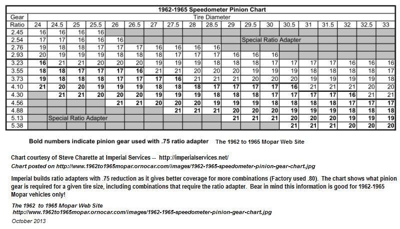

Hey this is XMAN JR. Im on my sisters computer. Anyone know where I can get a speedometer gear for my dads 62 polara ? The car has 4:10 gears & a 27.75 tall tire. For that year trany are they the same plastic gear as any or are they different ? I will be at my sisters until late tonight & I will stop down to her place Monday morning to see what you all came up with. Thanks
Looks like you need a 18 with a ratio adapter.
I have a 17 and a 19 for sale.
https://www.forbbodiesonly.com/moparforum/threads/1957-1965-speedometer-gears.152166/
Talk to 62 savoyguy2 he has 62 parts.
