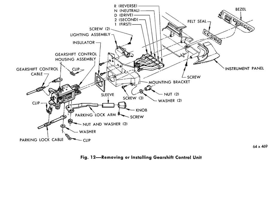

Here's what you're dealing with. It's a mechanical device without any adjustments. It can be removed and cleaned, lubed. The buttons are held in by a barbed connection. Care has to be taken removing them as not to mess up the plastic piece or they won't stay connected when reinstalled.
This is one I have for parts, one button is missing

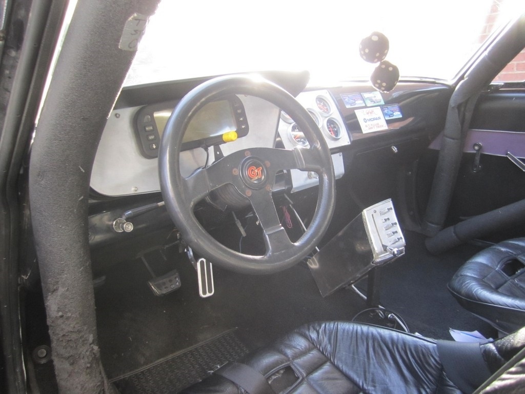

Post up a pic of your dash/shifter,you might have to remove the cluster to get to the shifter. I use a 64 shifter that has a removable cover

No. You shouldn't have to remove the mechanism pictured above. The buttons are plastic so there will be no welding involved but perhaps some gluing. First you'll remove the lower dash piece. Get your allen head wrenches out and remove the "park" and the "heat" knobs. Second remove the four screws across the face plate and gingerly slide it off the levers. Shop rag on the column will avoid scratches. Next you should be able to see into where the buttons attach and hopeful discern the problem. If it is not present there should be a felt "bushing" that holds all the buttons in place. If this felt seal is missing the buttons will feel awfully loose. There should also be one holding the heater button together. you can get an idea of what I am talking about if it is there. I would be curious to see the routing of the cable after the header installation as well. I too suspect binding of the cable.

Cables are either bound up or out of adjustment. The shifter itself is a pretty good piece, seldom an issue. The only problem I've seen is the fork that holds the button gets spread and the button falls out. Tighten with a pliers as needed. Make sure the cables aren't melted. Find a 62 -65 service manual a follow the adjustment procedure for both cables. Make sure the cable isn't bent right at the shifter itself. When they adjusted and not binding they work perfect. Both my son and I race 9 second cars with the stock push button shifter.

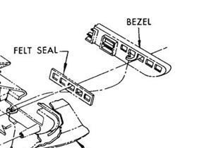

If the buttons feel flimsy it could be that the felt seal is damaged or non existent .
The felt seal has holes in it and it pushes over all the switches (heater too) and keeps the buttons firm without slop. It is placed under the chrome face plate.
